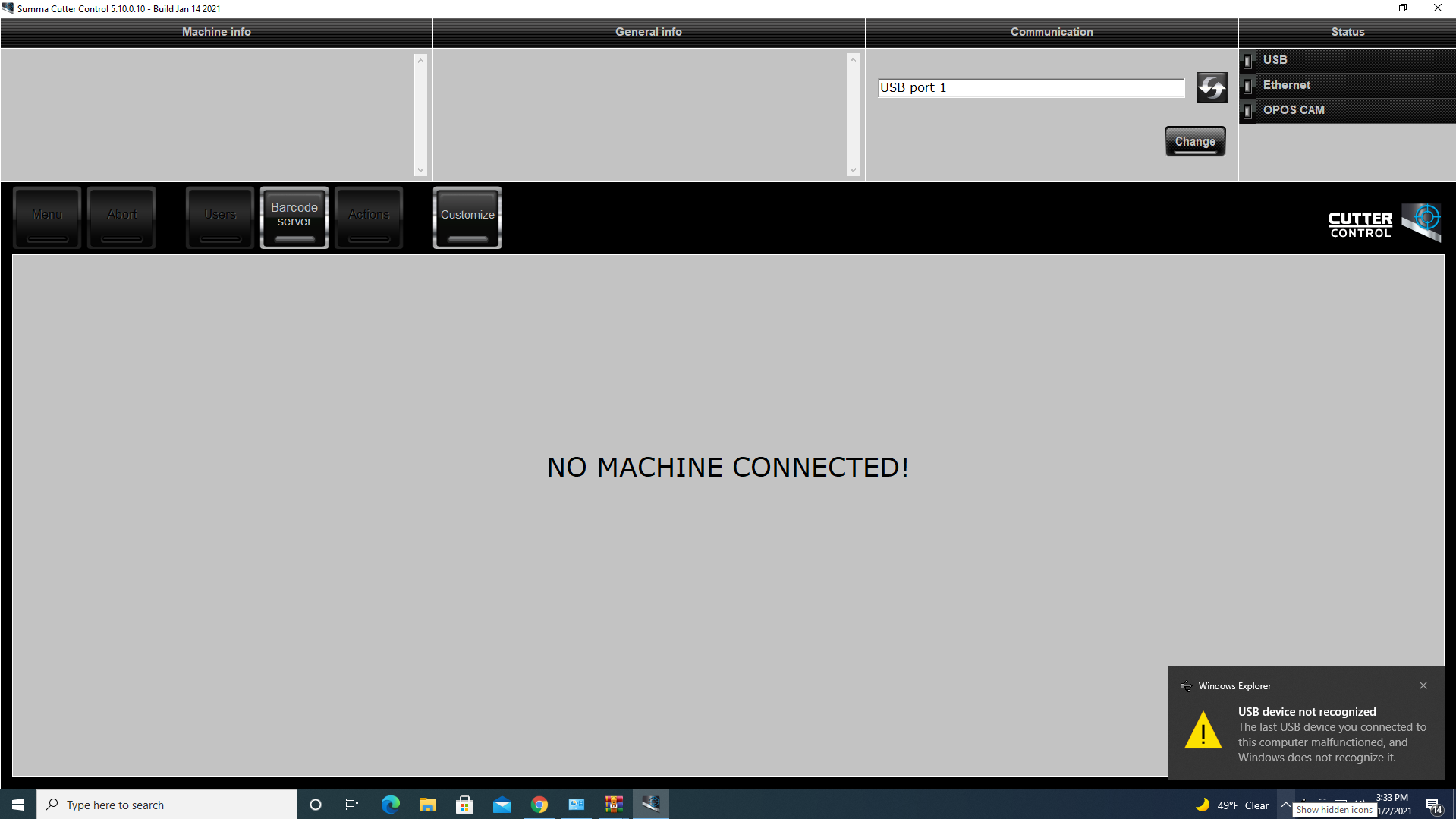

The first step in the process would be to confirm communication between the cutter and your
computer. You will want to install the USB driver for this model and you can download that here -
https://www.airmark.com/pages/summasign-pro-vinyl-cutter-downloads. On that same downloads page you can download the Summa Cutter Tools which include the Summa Cutter Control program and you will use that program to confirm communication.
After you have confirmed that the cutter is communicating with your
computer the next step would be to install a cutting program that is compatible with that model and Winplot is going to be your best bet for that. You can get Winplot on the same link above. Once you install Winplot you will need to setup your cutter when you are prompted to do so the first time you load the program. Make sure to double check your port selection in Winplot to match the port that it is actually connected to, which is usually USB1 if you have the cutter connected via USB.
Once the Winplot configuration is done you need to get the plug-in installed for Corel or Illustrator so you can apply registration marks to your file before you print. The plug-in is included with the same Summa Cutter Tools as Cutter Control and that will install at the same time. In Corel the plug-in will show up as a small toolbar and you just need to embed it in one of the open areas at the top of the screen and the next time you launch Corel the toolbar will be there. In Illustrator the plug-in is installed under the file menu under the name "Summa" and then "add OPOS XY reg marks". After the marks are applied and you have printed the job you just need to load the print on the Summa and then send the contour file to the cutter using Winplot and the "send to OPOS cutter" option under the output menu. The cutter will then prompt you to move the tool over the first marker, which is the marker in the lower right hand side if you are viewing the cutter from the front, and then hit apply. After you hit apply the cutter will begin detecting the various registration marks and start contour cutting right after that.
