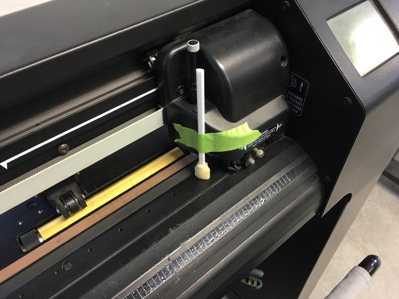

airborneassault
We run into the same issue regularly. I wasn't aware we could buy a kit to add pinchwheels which would be a huge benefit.
That said I have used the pictured method more than a few times to help keep the material down....please excuse the green tape usually I double side tape the swab with banner hem tape. You just have to be careful to not get too much downward pressure it just lightly needs to touch the material to keep it down away from the blade and pay extra close attention when you do the alignments sometimes it will want to snag the edge of the material. Works in a pinch but not ideal by any means.

reQ
Lol, that swab is a brilliant idea. I will try it today when i will be cutting thick snowmobile decals... always same problem with them
SightLine
Been doing that same swab thing for years with ours. I like using a cotton swab - seems less "grabby" on the material. Works great. :)

Bly
Actually just had this problem again even with the swab attachment - and finally realised there's a special nose piece for thick media.
Problem sorted.
