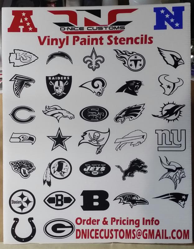

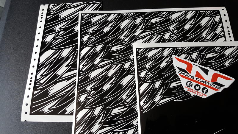

Currently looking to upgrade my main plotter from a Roland GX-24 to a Summa just don't know what model will suit my needs better. The D or T series S2 or summa cut series D75. I cut alot of small intricate stencils mainly used for sneaker customization and the Roland has been great but I'm ready to upgrade to a better quality machine as well as bump up to a 30" so I can use it to print and cut off of my SP-300V.
So my question is will I be in the same boat with a Summa series D75 as the Roland? Or will bumping up to a S2 D or T 75 be the best route? If so is the T really worth the extra $1500 . I'll attach a couple examples of the work I do to show the details.
The 1st sheet usually is a 14x14 the 2nd sheet of logos. Each logo is roughly 2x2

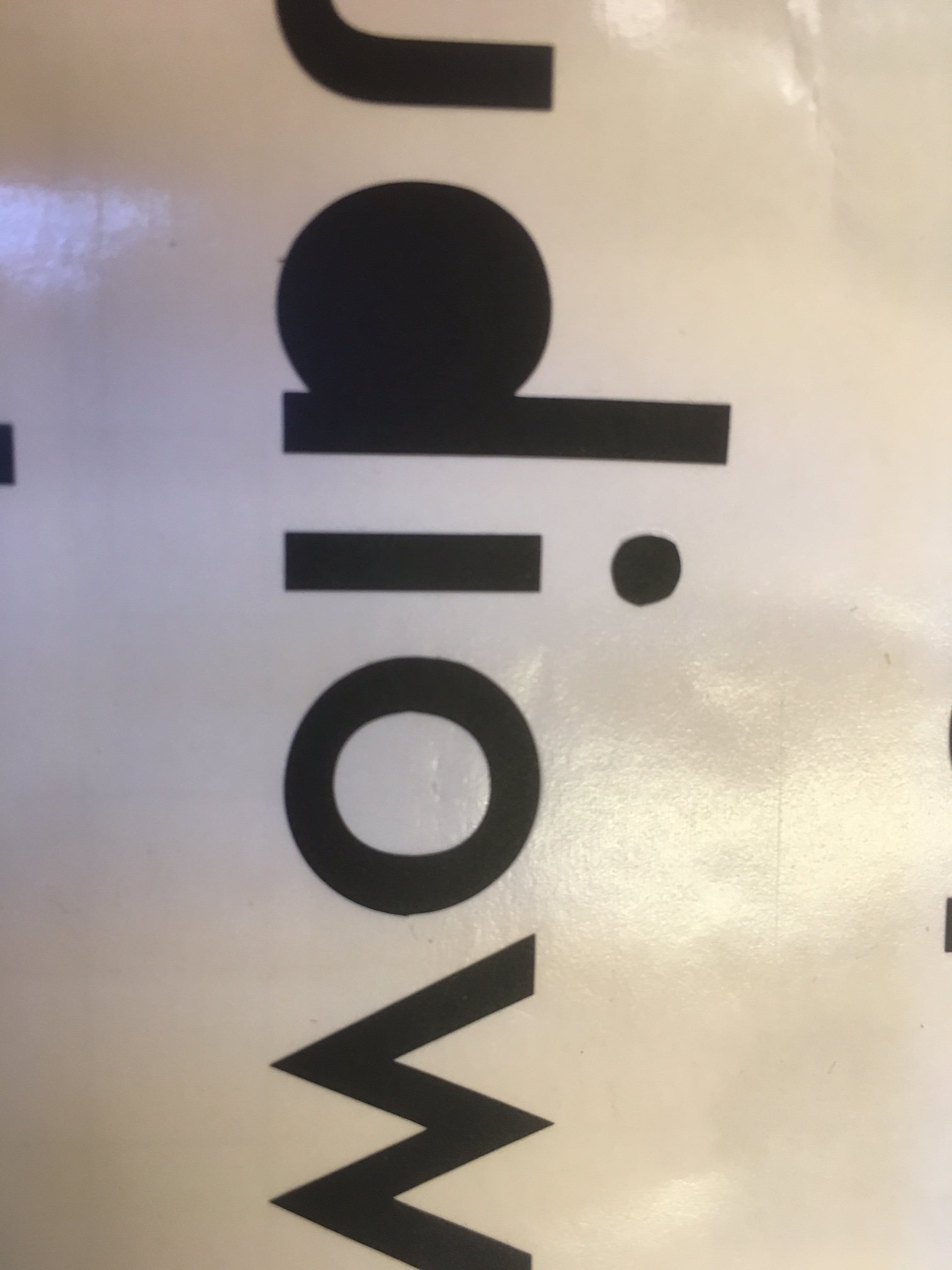

I just got a tangential and it's terrible. The worst plotter I have ever owned. After 2 weeks of troubleshooting with SUMMA which included: Leveling the blade holder, changing the blade, swapping out the blade holder changing the speeds, depths pressures, velocities, material. As well as changing software MAcsign, Winplot, Flexi..... and multiple fonts. I was told it was the material. Oracal 631. A 2mil matte finish vinyl they claim "shifts" during cutting. Thats like selling a Ferrari that doesn't take unleaded. When I ran a thicker material ORcal 7510 through it, the cutting was a joke. See pic to see the sad performance of this cutter. Whats even worse is that the company will only give me a 85% refund. 15% restocking fee, if upon arrival it works. So I am basically stuck with this lemon, that does not work. I've attached a picture of the SUMMA S2 t75 at its best. Notice the i's and o's.....

Hey, I'd be happy to try the cuts on my s2t if you give me the sizes of what you are doing, I can test 631, 651 and some others.
Bly
There was one vinyl that wouldn't cut properly on mine.
It was cheap stuff and the backing paper was so soft the grit rollers were chewing out the paper causing the job to mis align.
The S2 is far and away the best fastest cutter I've had.
Getting the barcodes to read can be tricky is my only real complaint.
