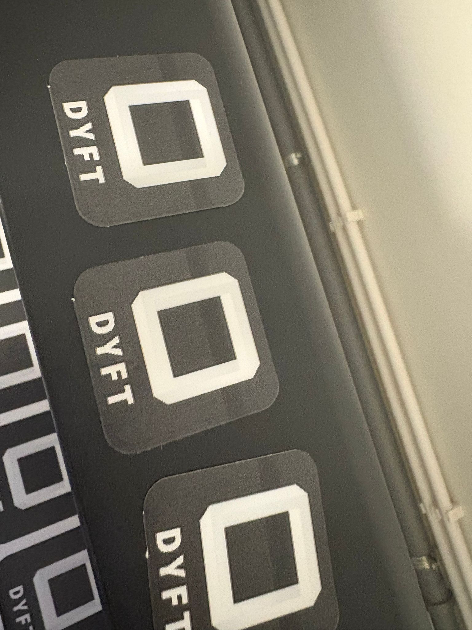

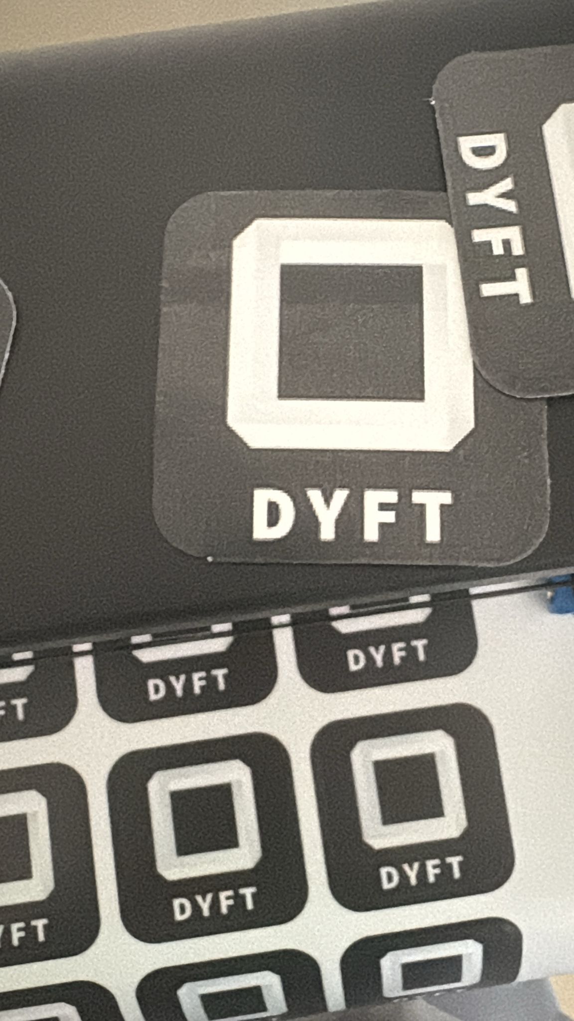

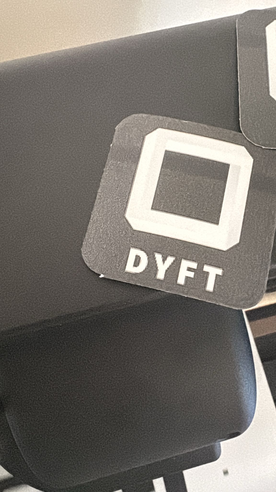

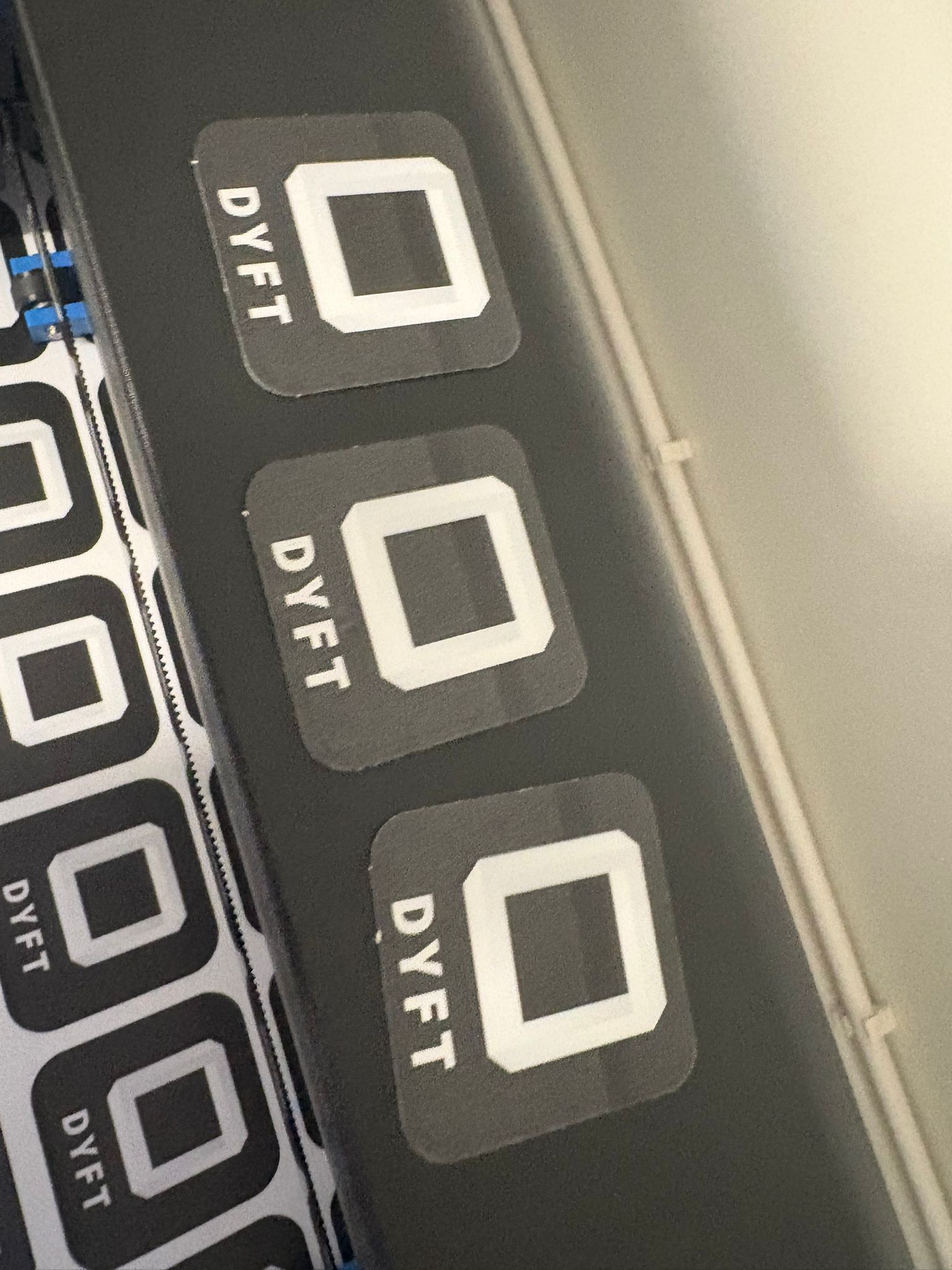

I have a summa S3-T140.
I do a lot of Thru-Cut on it.
When it was new, the cuts were perfect.
After a few changed Knives, the thru-cut is not that perfect anymore. It has a spos, where the sticker remains stuck.
I changed the strip with a new one (a tehnician did it)
I changed the knife, also did an offset calibration, opos calibration and still not ok.

jerry369
what full pressure did you set? and flex velocity?
if possible try to reduce one of the two or increase the space between the shapes
AfroChild
Incresed the space between the shapes. still not working
Full presure 320g, and flex velocity 200mm/s.
They are not dropping from the support.
jerry369
I'll try by reducing the flex velocity, you can also enable multi pass to reduce the pressure or use a different knife (45°)
Unfortunately with flexcut there is no certain rule to get a good cut, the only rule is ...trial and error
