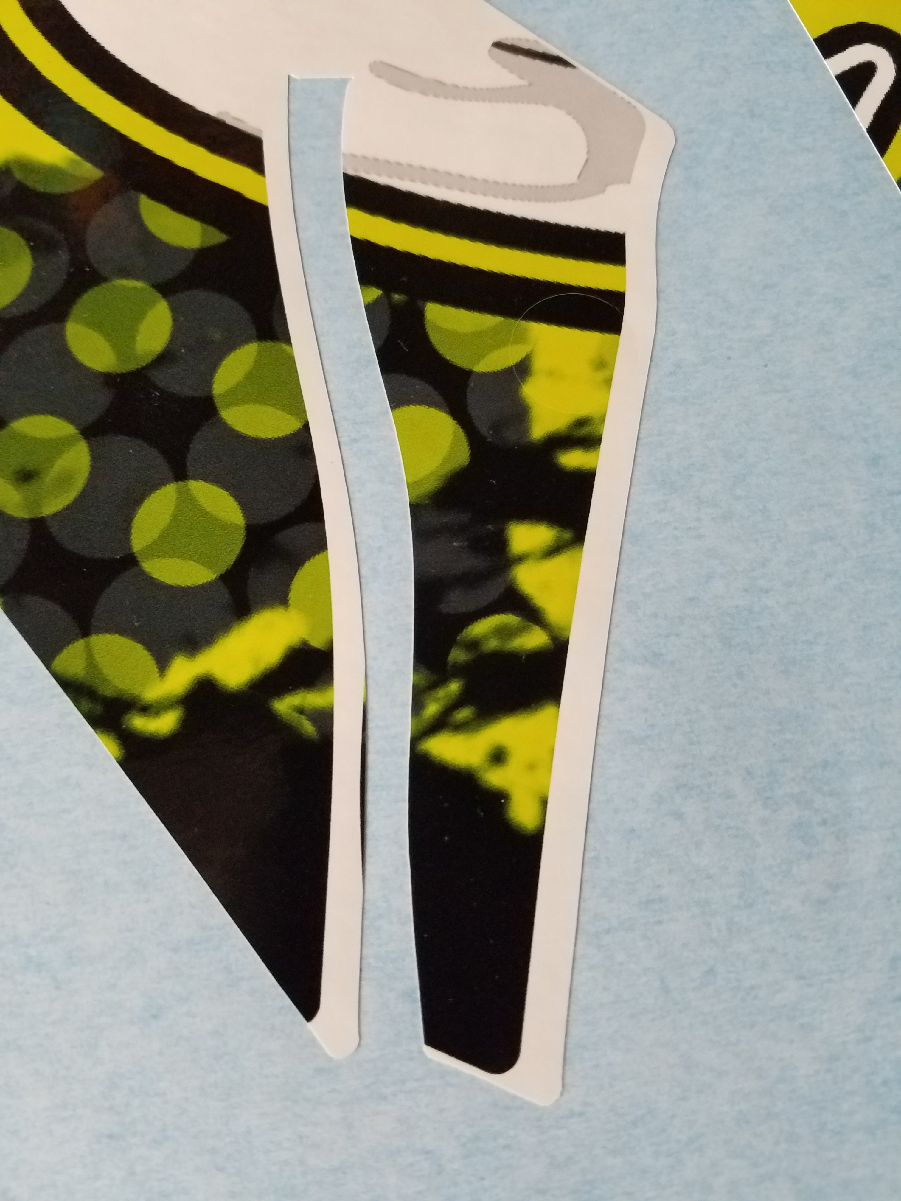

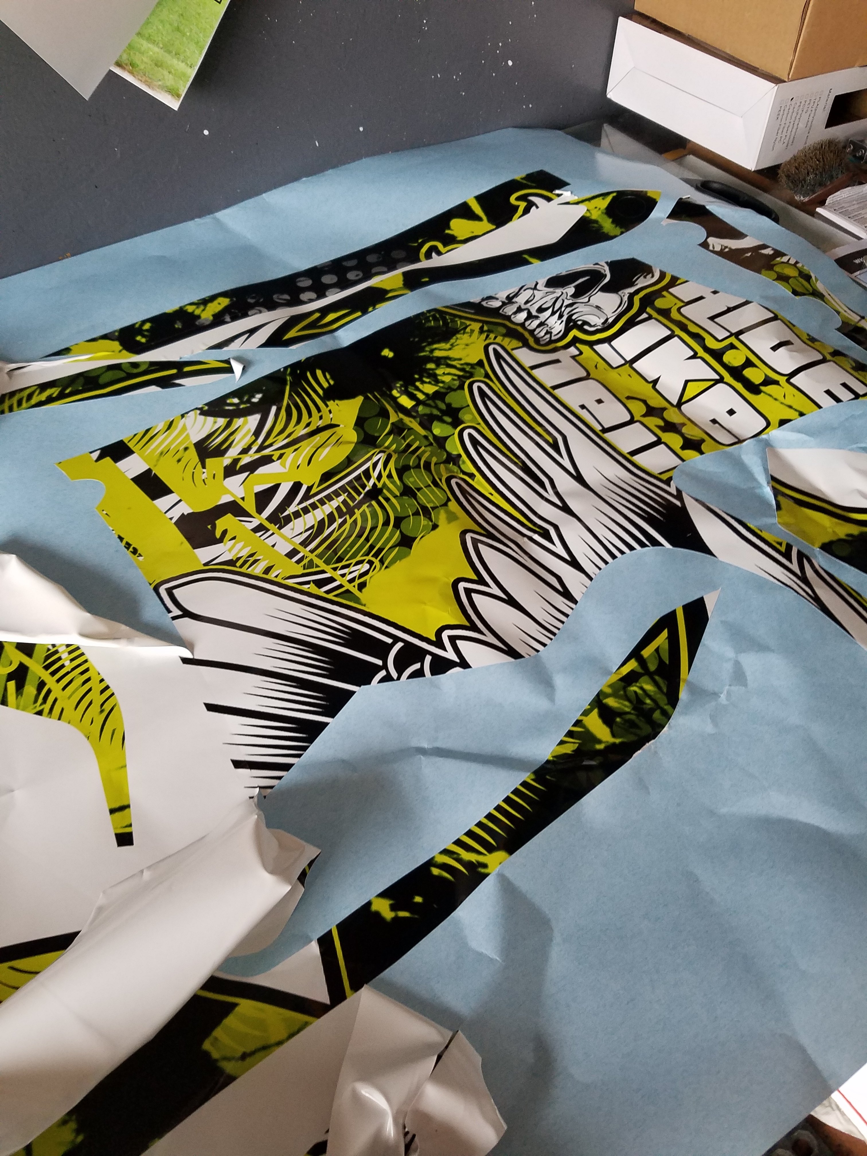

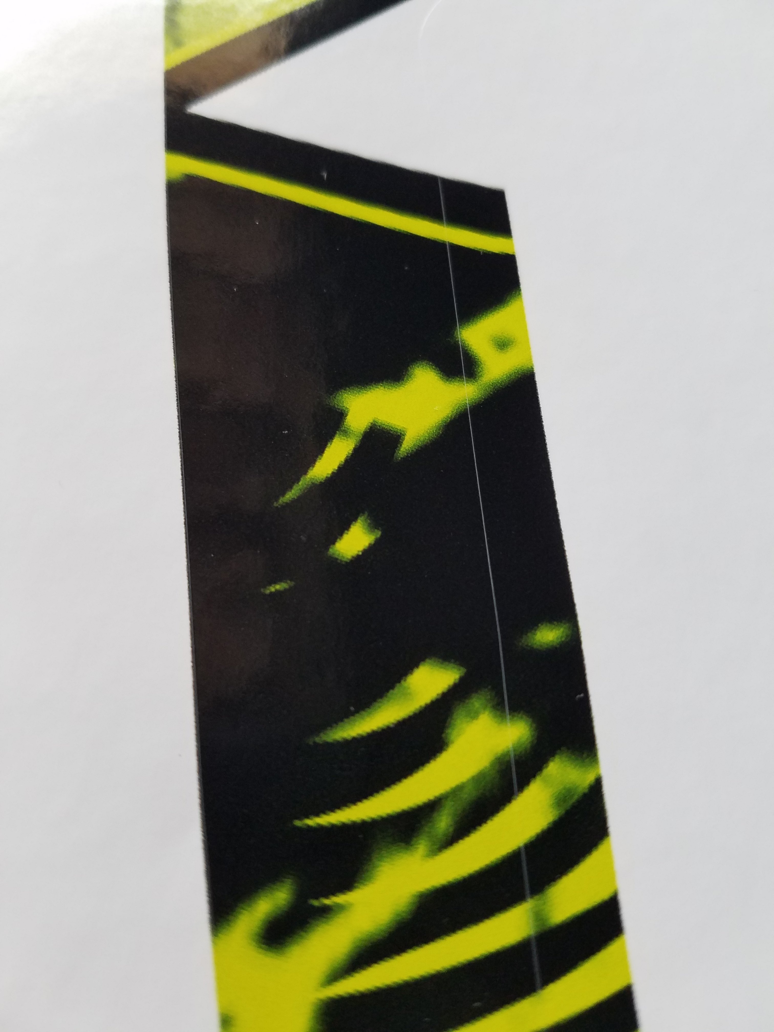

I wanted to give an update , I just ran a test with normal briteline vinyl with no lamination at all .
Same exact result ! My thick media does NOT seem to be the issue !!!
PS ,This was the 2nd test after I ran the OPOS calibration .
OPOS Calibration did nothing to resolve the issue .

I just did the OPOS calibration 3 more times just to be on the safe side, Did a print and it's the same issue . It's cutting right on the border and not inside the graphic as I put it .
