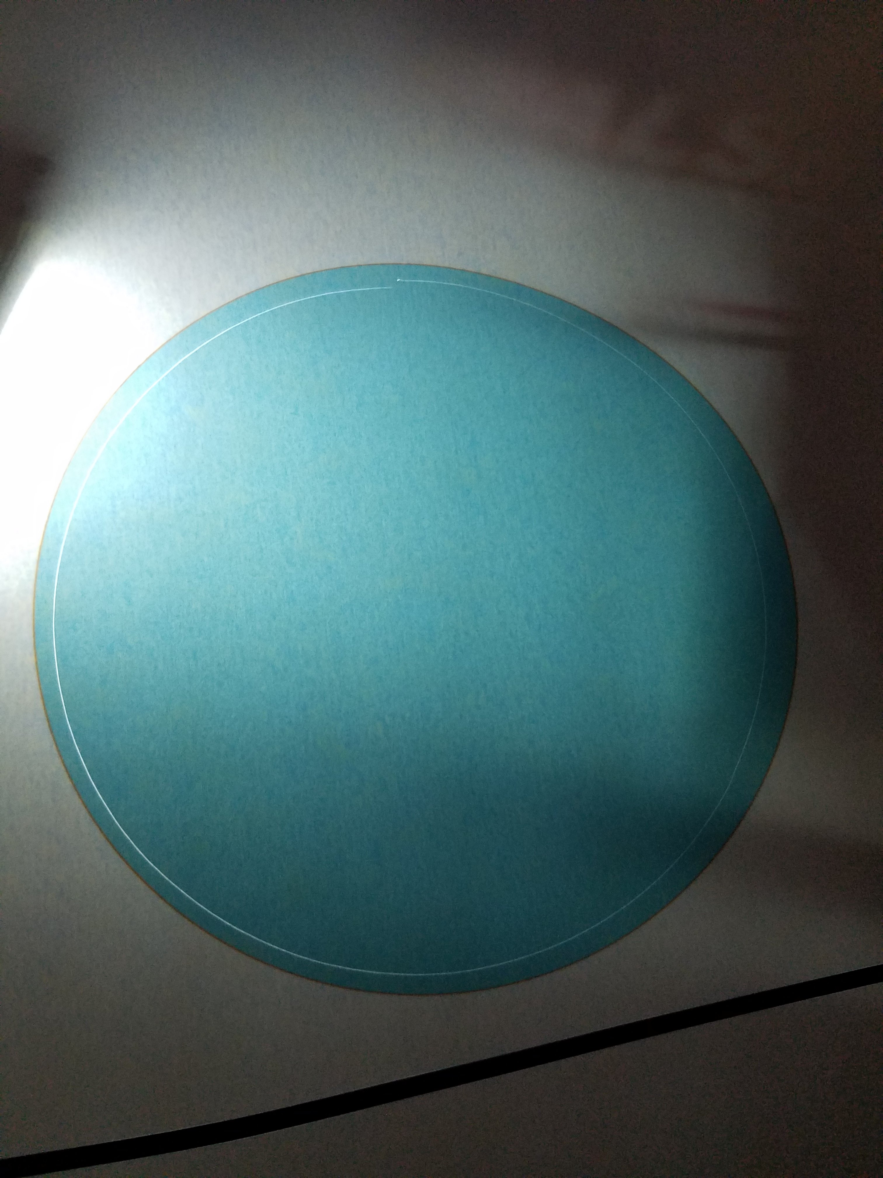

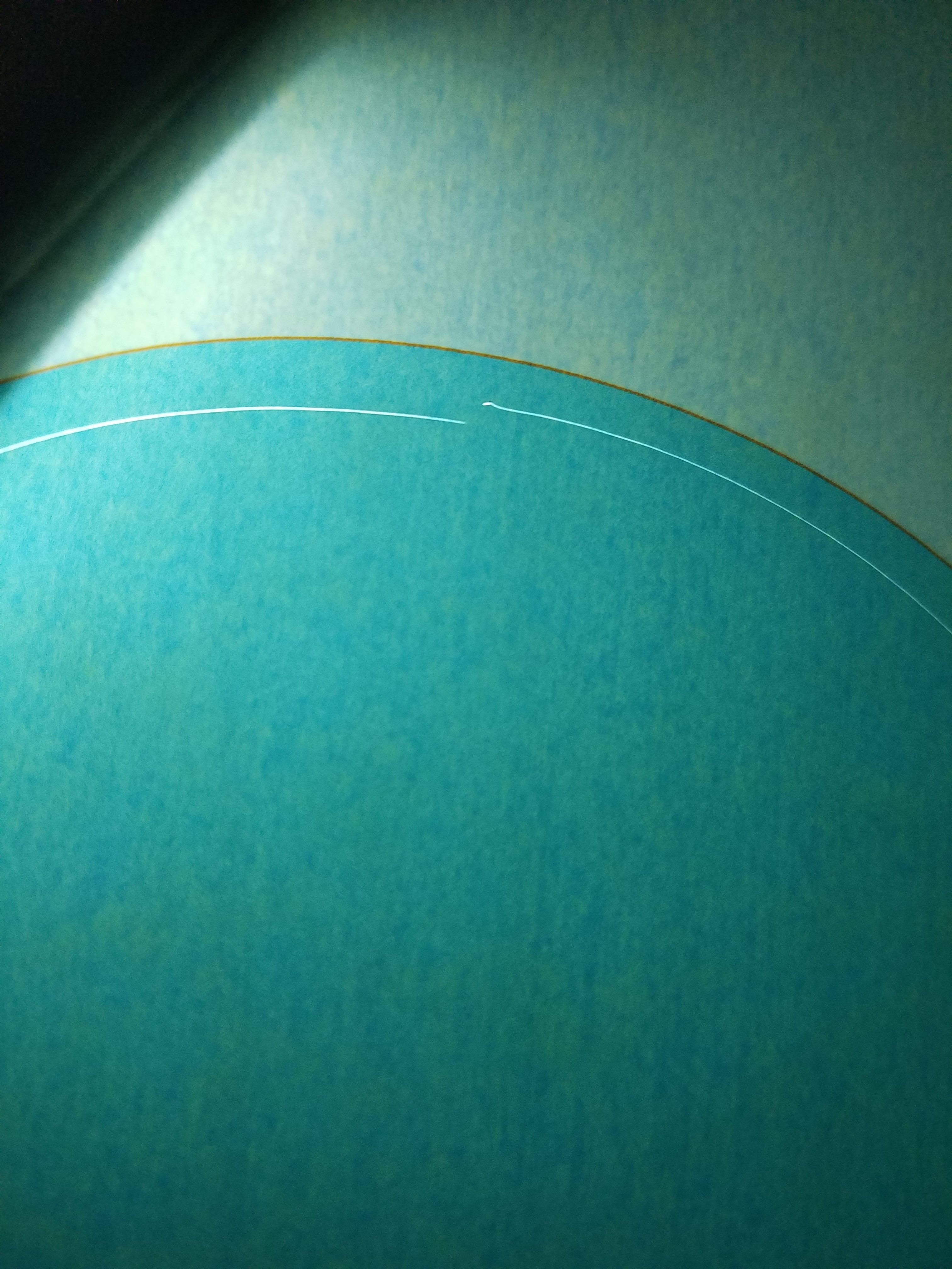

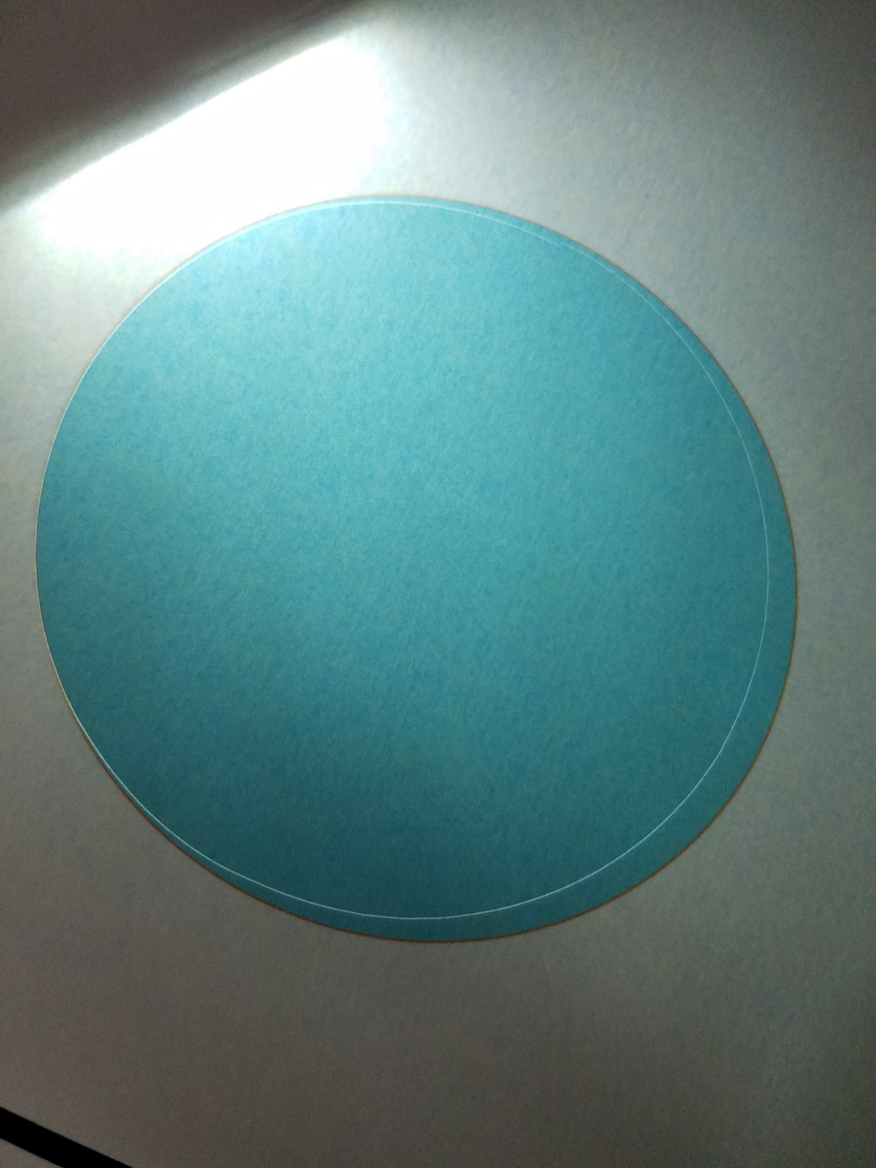

OK , I ran that test , All of my cut lines are still off and I notice the cut's are not even 100% closed .I wish I could show you with a picture but with the lighting it's tricky . It seemed to cut the crop marks just fine though ..
I guess I need to do the test again in black so I can show it better . But either way , it's still not correct .
autoexebat
I put the vinyl under a flashlight , now you can see my issues . This is crazy for the money I spent !

balstestrat
Problem Solver
Still seems like a file issue if it cuts the reg marks correctly.
Have you measured that the printed file is 100% the size of the original and there is no skew or barrel effect on it?
If you send that same job without the OPOS it should cut those circles perfectly.
You are using hairline for you cutcontour, correct?

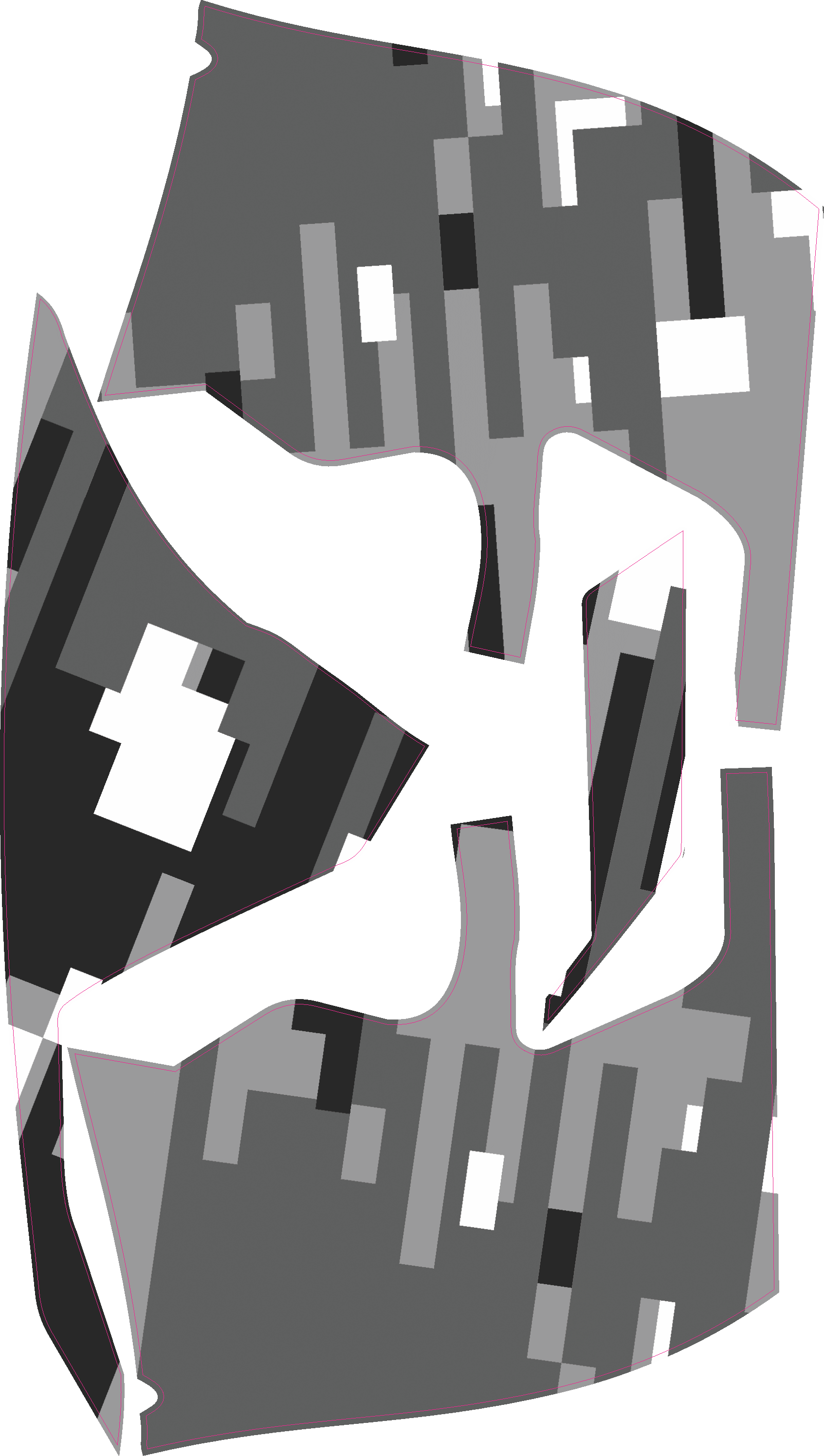

autoexebat
I figured out a way of doing it in corel but I have to make a full copy of the reg marks , another stem and a bigger hassle .
Testing now .
