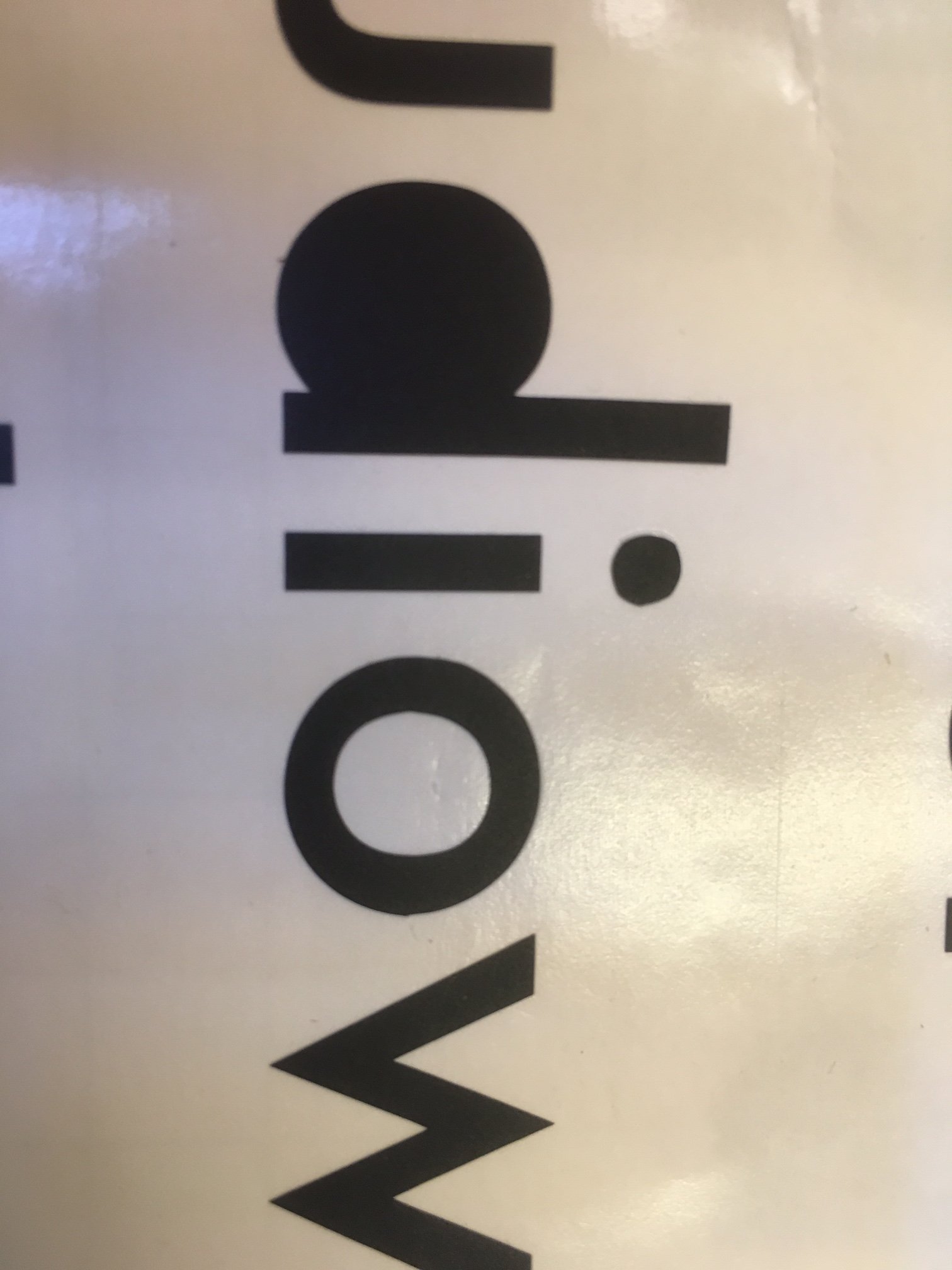

Being that it can barely cut Oracal 631, I'd say no. See pic. Worst plotter I have ever owned.

We cut reflective prismatic on our summa all the time. It works perfect, you need to adjust everything right and it runs like a champ. To the poster that says it can't cut 631, it looks like you need to better adjust blade depth and pressure and it either looks like you need to adjust your file or turn off curve smoothing.

I got a lemon. It happens. plain and simple. I did every fix recommended on this site and via their customer service. Nothing worked.
