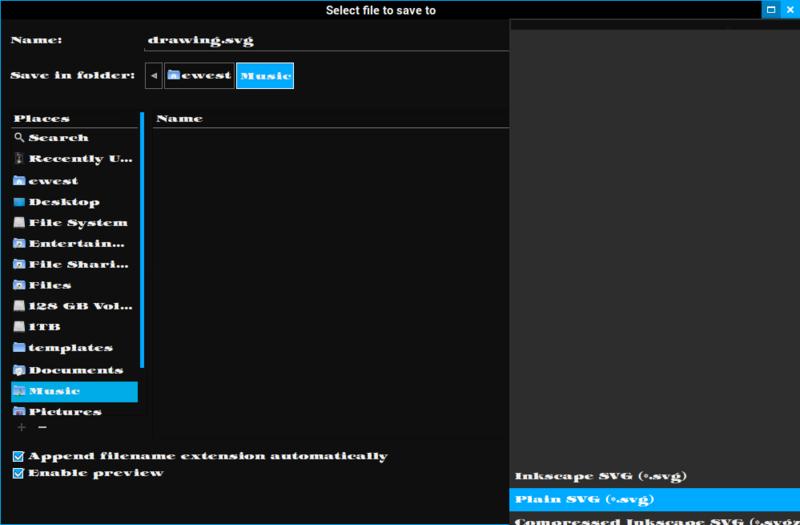

In Inkscape, there are actually 2 SVG file extensions. If they used the first one, that could be why having the issue.

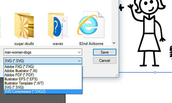

Adding more insight to this reply:
It is not only Inkscape that causes the issue - many programs have the option of saving as either "compressed svg" or plain svg. I will often times have issues with the compressed svg files being all jacked up when I import them into my cutting software. The best fix for this (that I have found) is to open the offending file in Illustrator and save again as a plain svg.
Compressed SVGs though, usually have a different extension compared to that of say Inkscape SVG versus Plain SVG.
