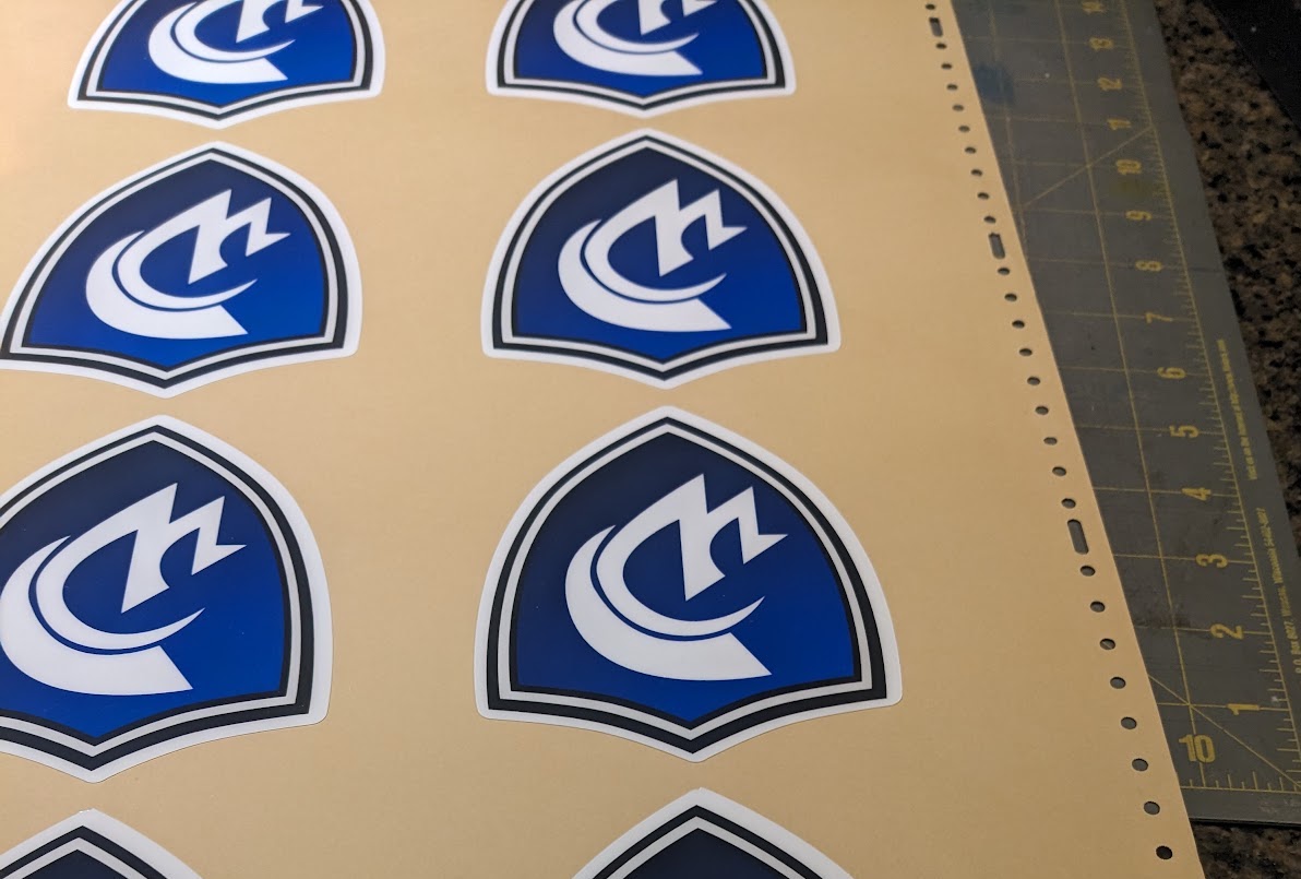

FWIW, I've done a few teams worth of helmet decals for couple years now. I print them on 6 mil Substance and laminate with their 15 mil. Printed on a BN-20A. That being said, the Roland will NOT cut them cleanly, even with multiple passes. On the other hand, my Graphtec CE7000 works great for it with no drama whatsoever.
The Roland can use punched media if you have some leftover to use up (I bought some accidentally to start when I ordered from Substance and just ran with it instead of returning), but you're losing a little printable area and they aren't sprocket-feed, so no need for that when you re-order. Hope that helps a little!
