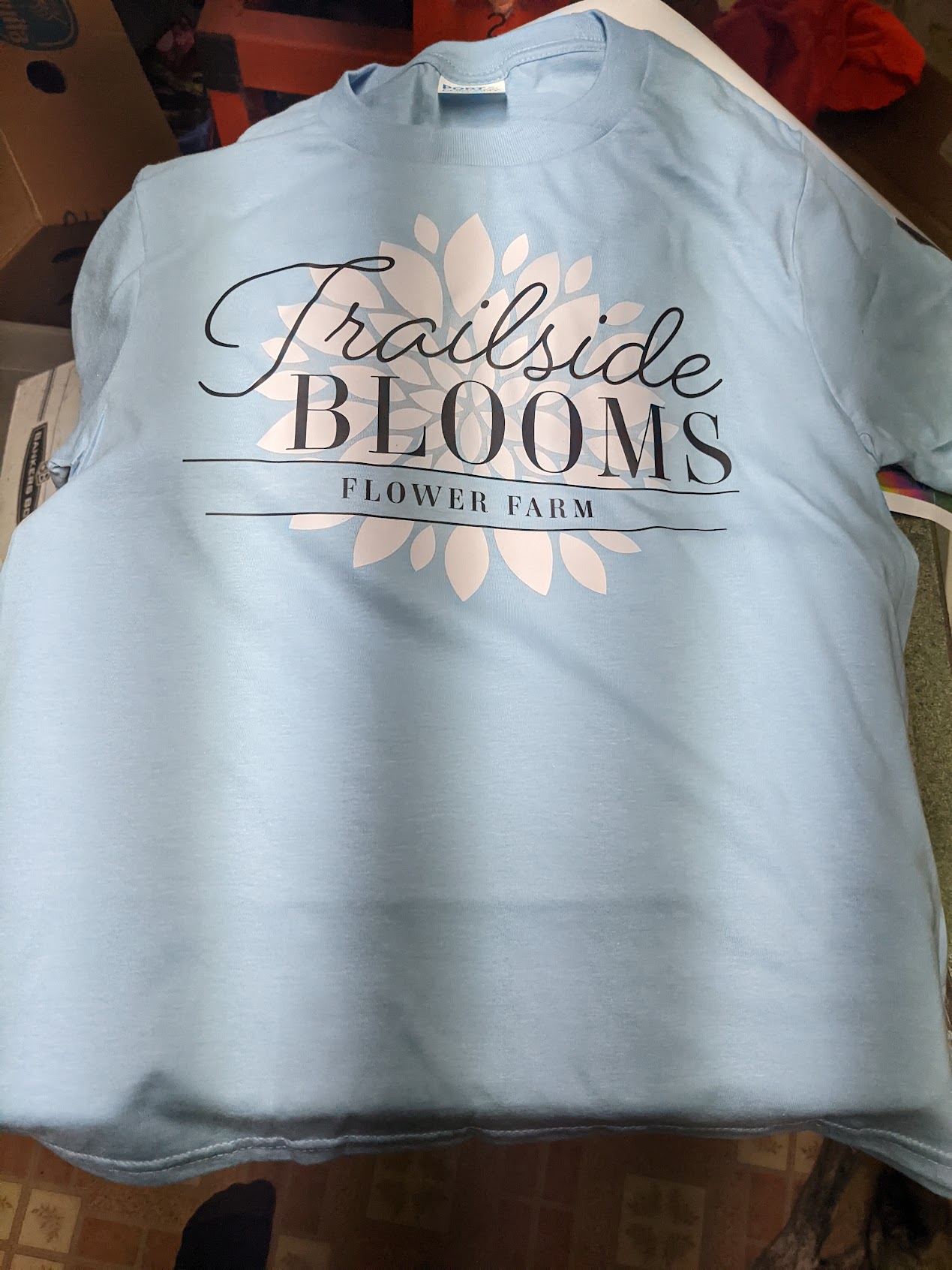

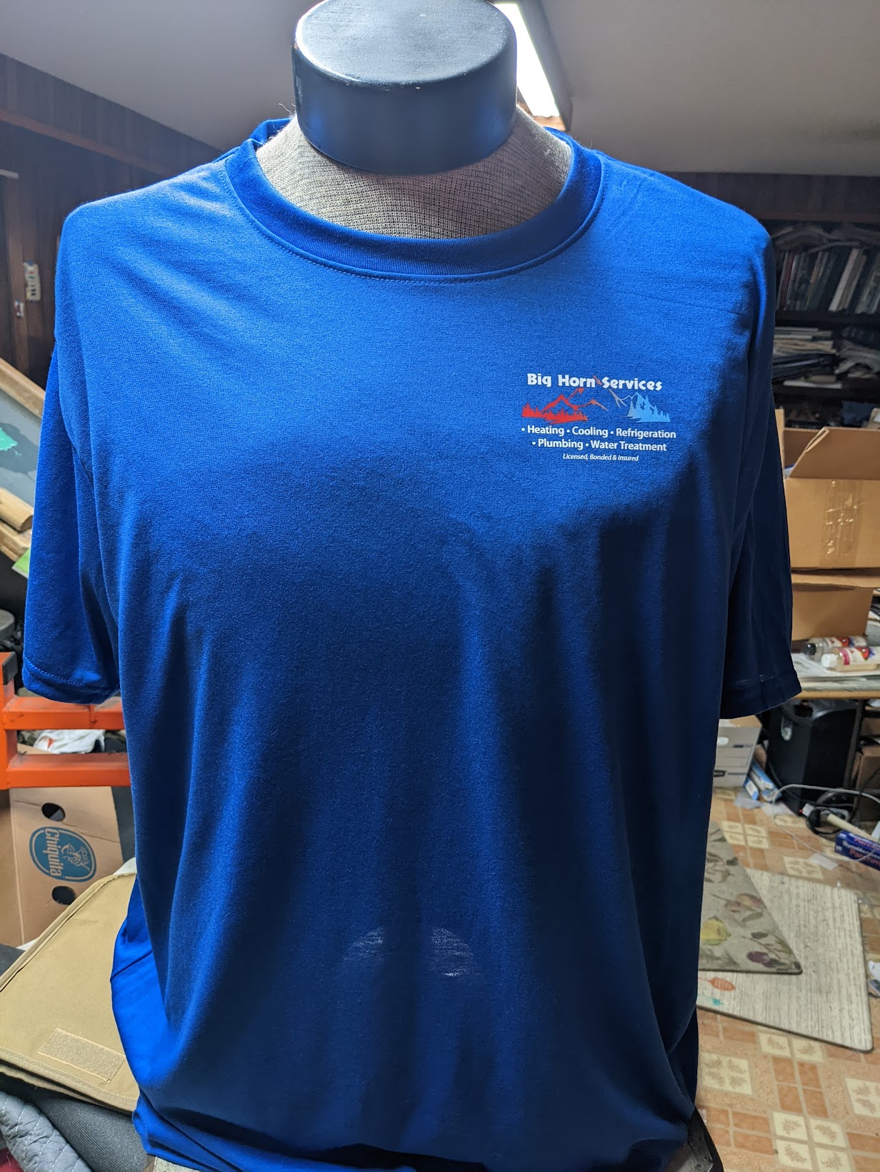

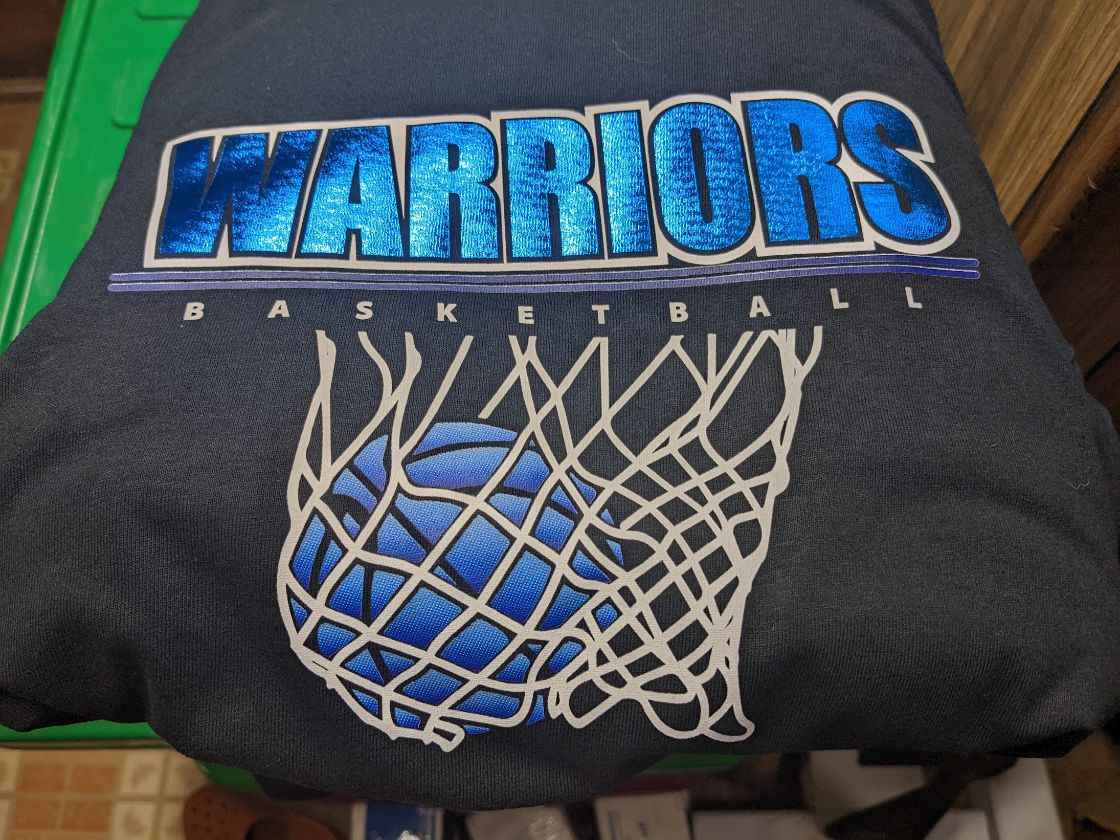

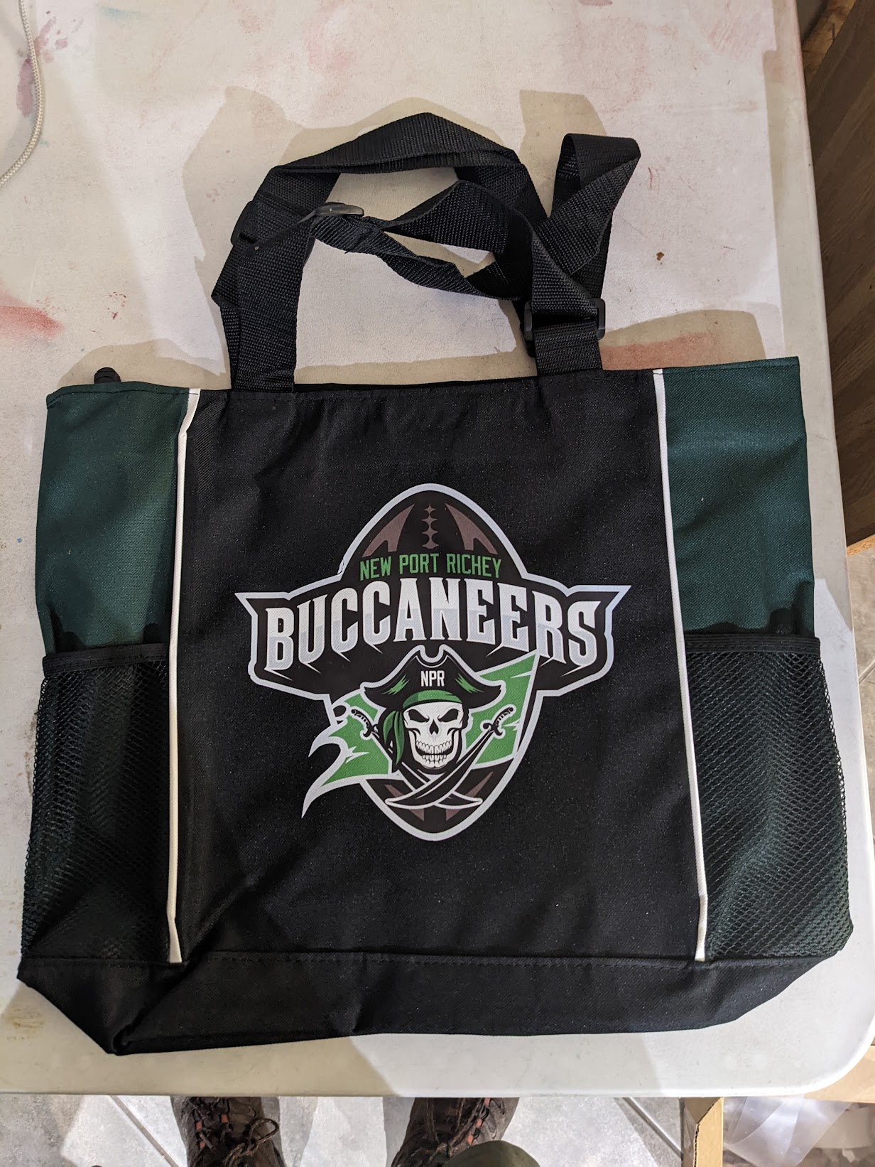

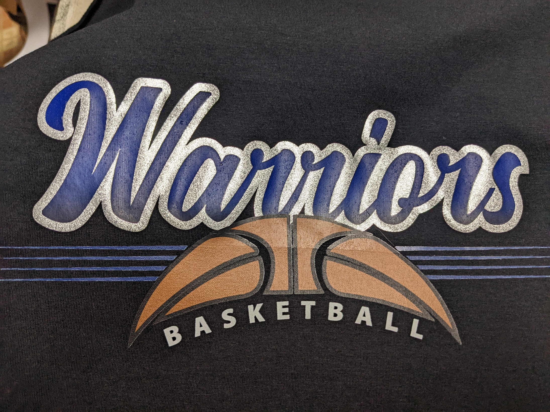

Here's a few recent ones. The last 2 were combined with extra bling by also layering cut HTV with them.
