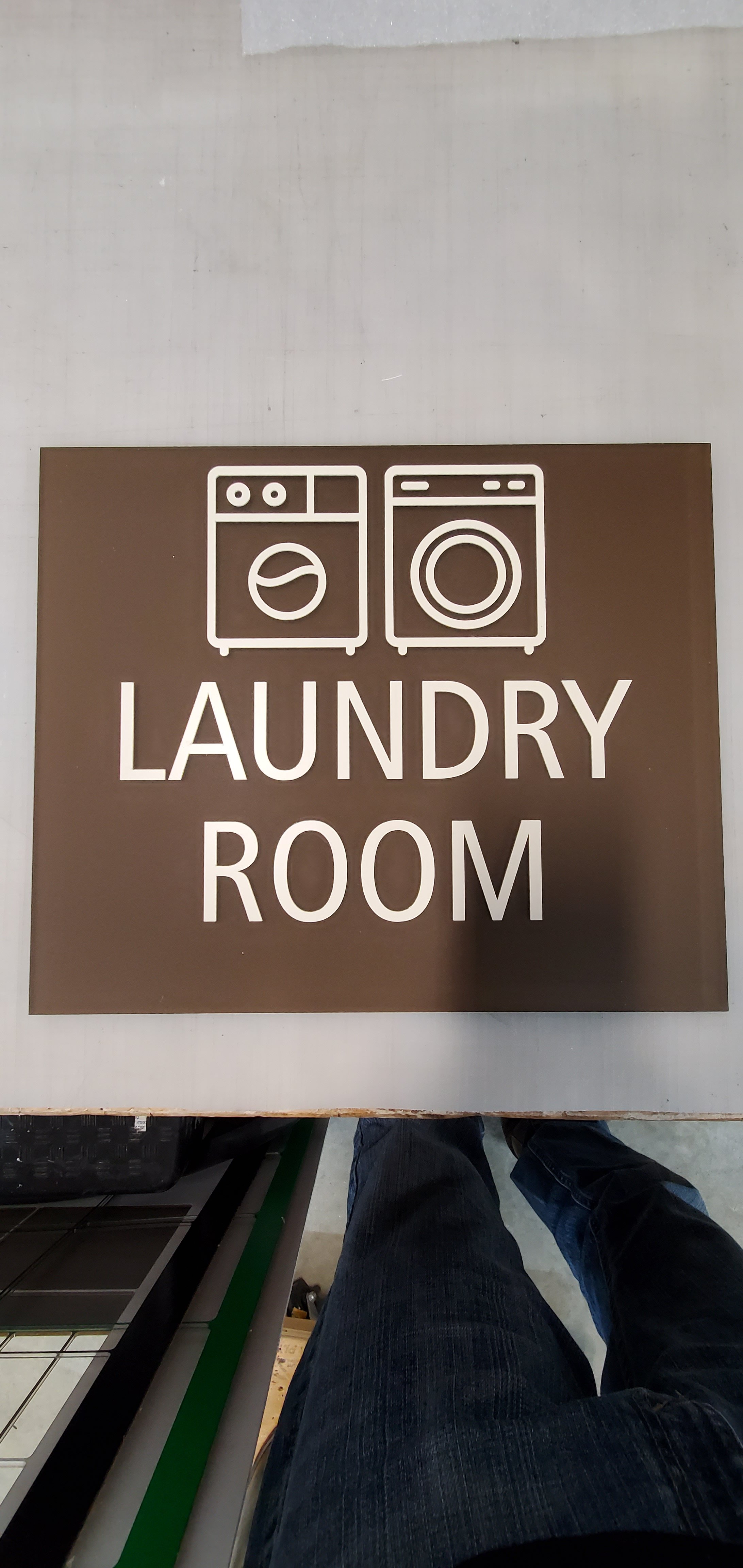

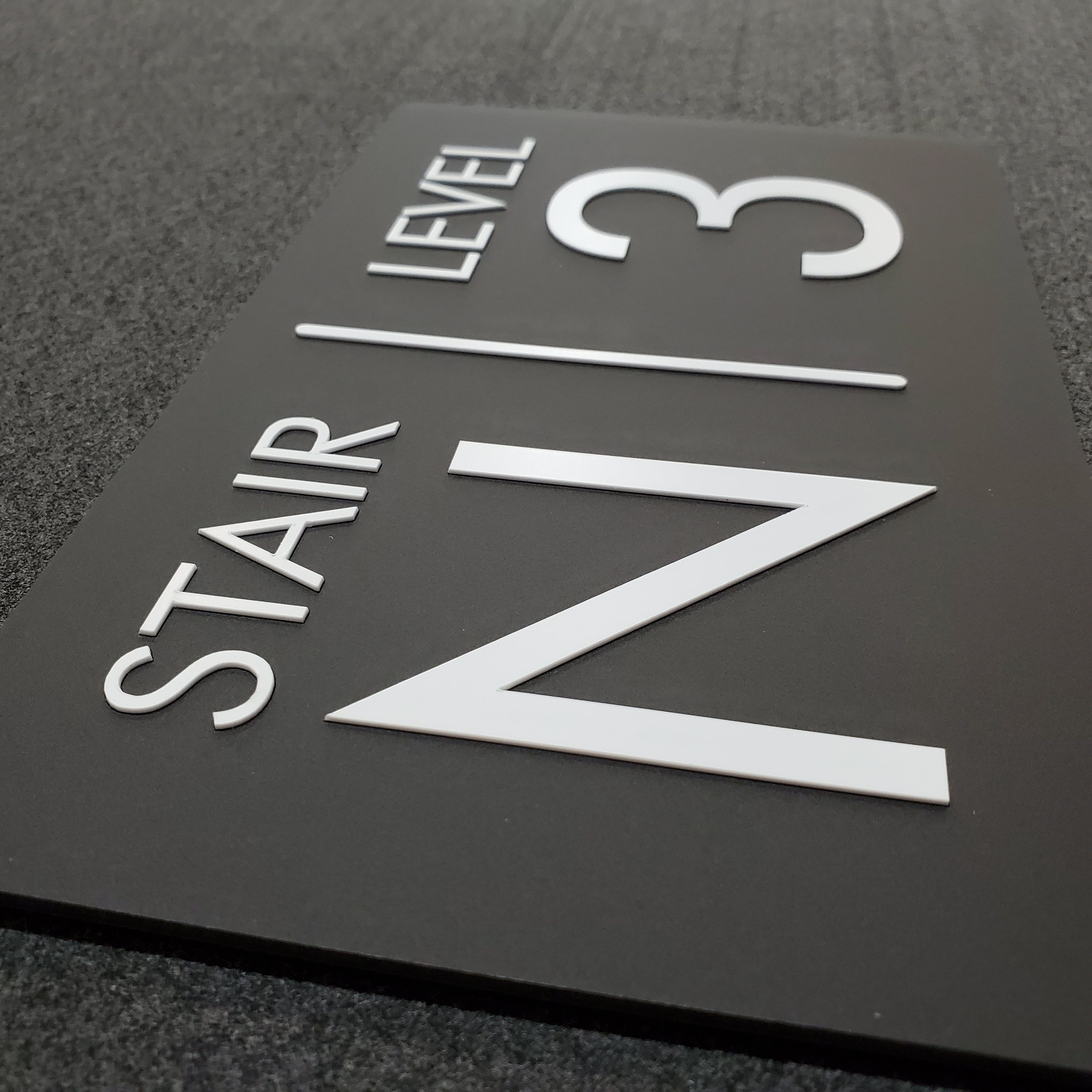

You're that guy hand placing applique! Have you tried it with the rotary engraver after the material is already stuck? I'm so curious how this works out. Got a shot of a finished product?
Our current process is to stick the applique on the sign, put it in the laser to cut, then weed it off, no issues except we are limited to using P95 acrylic, if we try to use glossy acrylic or even non-glare, the tape from the applique sticks to well to the backer and leaves tons of tape behind when weeded off.

Oh I see. Yeah, every time I've thought "I'll make a really cool sign with raised copy on a glossy material!" Then after 15 minutes of picking at adhesive, I give up. It shouldn't matter much, ADA requires a matte or at least non-glossy finish. Any reason you don't use the rotary for this? These do look nice and crisp.
Speed mostly, the laser cuts the applique much faster then the rotary, the laundry room sign is about 8"x8" and the laser would take about 20 seconds to cut the applique on that sign, plus there are no little chips to clean up.
We run a vision 1612 for our rotary, and while its a workhorse, it's also a PITA to run, always some little annoyance in the software. I try to avoid using it at all possible, its mostly used for braille and diamond dragging trophy plates at this point.

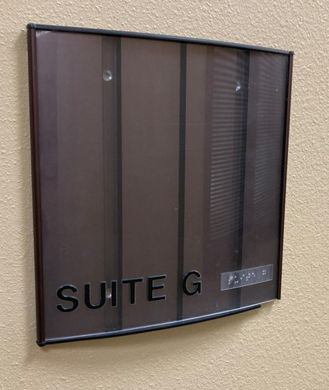

I'm bidding on a job for directory signs in an office building. A new wing was recently subdivided into 20 offices and they want to try to match the signs used in the rest of the building. The signs are about 8x8" curved plastic with tactile letters and braille. Image attached, this looks like a stock item I can just order. Tried a Google image search but haven't found anything close yet. Any recommendations?

I take it you recommend this one? I got a quote back from them and it seems pretty high, like my cost being the same as what I'm seeing on a retail office sign site for a similar sign. Graphic Components responded saying they're at capacity and not taking new customers, but gave me a few other shops to try:

No, I didn't recommend it, but that looks like my sample here in the shop. Don't get mad at the messenger. If you can't afford it, look for a knockoff or talk them into something else.
Like I'm always saying.... along with some other members, it's only high in your eyes, not to people who have been doing this as a business for years. You get what ya pay for. Wanna race to the bottom, go ahead, but when moving into your new digs, are you gonna cut all the corners and put second best in for yourself ?? I would hope not, but it could happen. Ain't no frickin' way, I wanna be known for always finding a deal for someone.
Remember, ya have 3 things in business, which determines your reputation. Price, craftsmanship and service. Ya just can't have all three at once. Two so one must be omitted.
gnubler
I got a few quotes back and they're all within the same ballpark, so at least I know what I'm dealing with now. Talked to someone at Howard Industries, really helpful. Thanks for the input on Vista. Their quote was in line with the others, so not expensive as I originally stated.

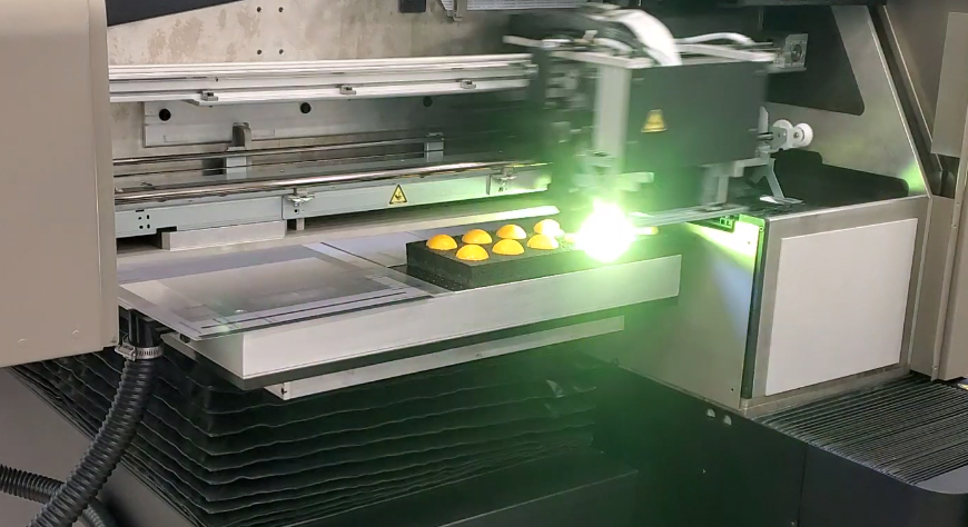

At Howard we have two vision engravers and two DCS 7200z flatbeds. Both run from CADlink software.
Most non metallic raised/ADA is all done on the DCS machines. The DCS are very finicky and require a fair amount of cleaning/maintenance to keep them working well. Great for mid sized runs though. They also produce some fascinating results when printing on glow-in-the-dark or fluorescent stuff. Golf balls startled me at first.....like little suns
Had to make a topper and a bigger jig to minimize the glare. Was NOT expecting it to be so bright at all.
