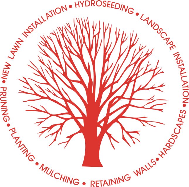

Jillbeans
Thanks for all the help, folks.
I literally was so frustrated I walked away from this and only came back to it this morning when I was relaxed and fresh.
I did this in GA in about 5 minutes, but it is still not perfect. Gonna read the suggestions and try to learn a new/better way too.
Again, thank you.
And Pat, I will make you a big pot of chili and a slab-o-cornbread if you are ever down this way.
Love....Jill
Jillbeans
Ack! He changed the text again.
This time I used the suggestions and it took 5 minutes.
hahaha
THANK YOU!
