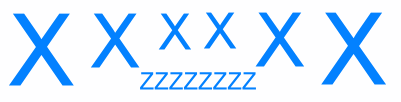

Text "end stretch" in Flexi?
trakers
What I mean is where the end letters are taller than the middle ones.
The tops of the text remains flat while the bottom curves, longer at the end.
You see this a lot of time with additional smaller text tucked up in the curve.
Below is crude example.
