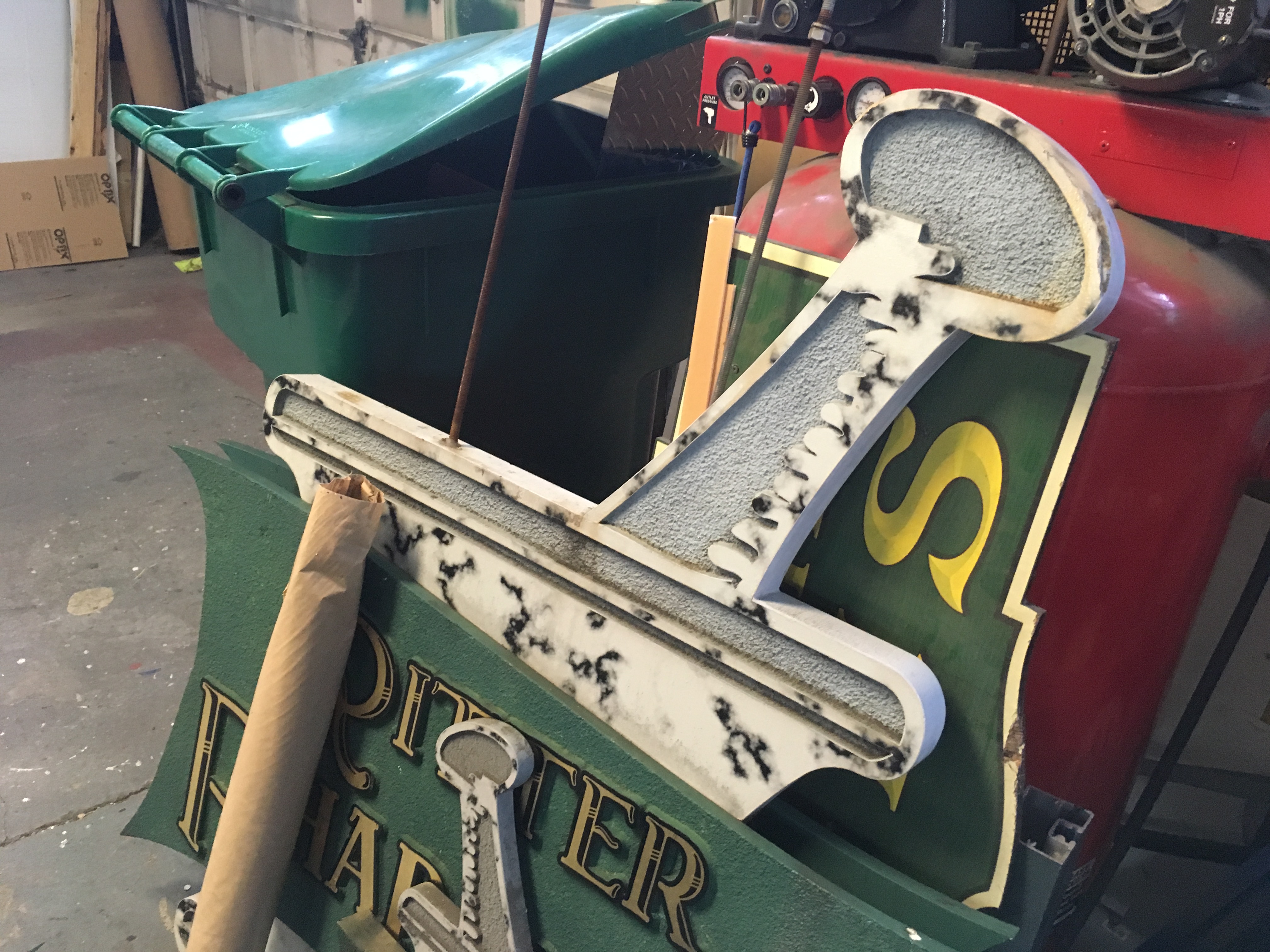

Incorrect. Edge prints don't need to be laminated. That's the joy of foil over ink. I'm attaching a photo of a sign we just took down in the last week or so because the pharmacy went out of business. The sign was made in 2007 and the marble effect is black Edge print on grey vinyl. 12 years outside in the weather and sun and it's not even peeling up. Given the time it was made, I can say we probably used 220 with a Spot Black print with UV abrasion guard.
I have a client with a van that we wrapped the panel area with a full color seamed Edge print. That job was done without the abrasion guard, and we may have had FrogSkin at the time (I can't be positive, it was a long time ago). Same thing. The stucco background is still perfectly clear. Some fading, obviously, but not completely washed out like I see with ink prints that are laminated.
