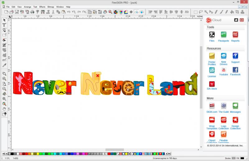

Just downloaded your attached pdf and opened it in Flexi Cloud, it was perfect. Just FYI. So I'm not sure what the masking does in Flexi7. Can you send a screen shot?
Did you try to open the PDF you made in Flexi7?
gabagoo
It will open in Flexi, but you can't edit any part as it is basically masked...so trying to build a cut line is impossible until all masks are removed...and based on that design, you know there are countless masks. I guess I need to upgrade, but not going to at this point.
mrugen
Adding cut line
I assume you are talking about contour cut lines. Did you know that you can DRAW them in, then select the final vector and in the ARRANGE menu choose CONTOURCUT>MAKE CONTOURCUT to convert the vector to a contourcut. Just use the digitizing pen to draw the lines you want. Nice part is you can edit that vector before you convert.
