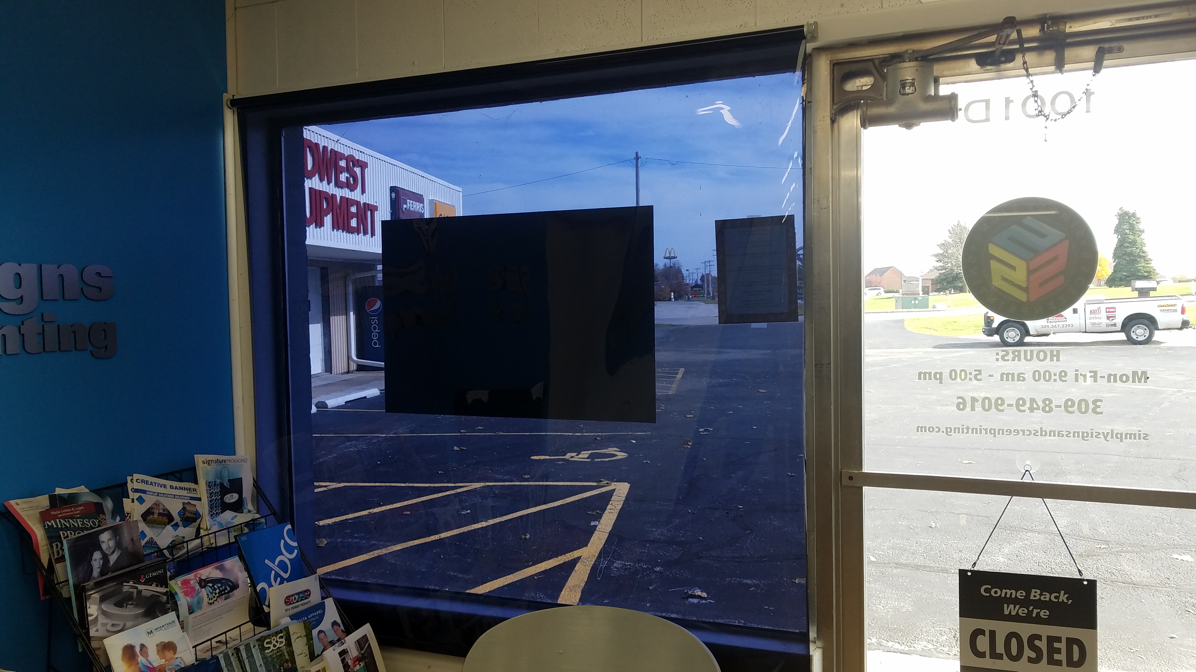

Here's the option we went with in our shop. These are tinted screens that roll up or down. The quality of these things is excellent, as we have many days when someone comes through the door and the wind hits them, but the film doesn't kink or scuff no matter how bad it gets whipped around. I couldn't tell you how much this option costs, because we traded 100 printed t-shirts for four of these shades and installation from a local tint company. It's a nice option if you like letting a little light inside at times.
