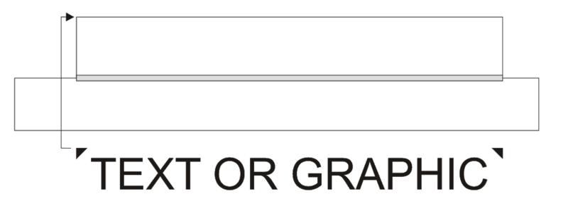

On glass I would definitely wet apply the first layer. Dry on the next layer is fine. I tack down another oversized substrate the same thickness against your sign. Hinge along the edge of the 6ft length.
