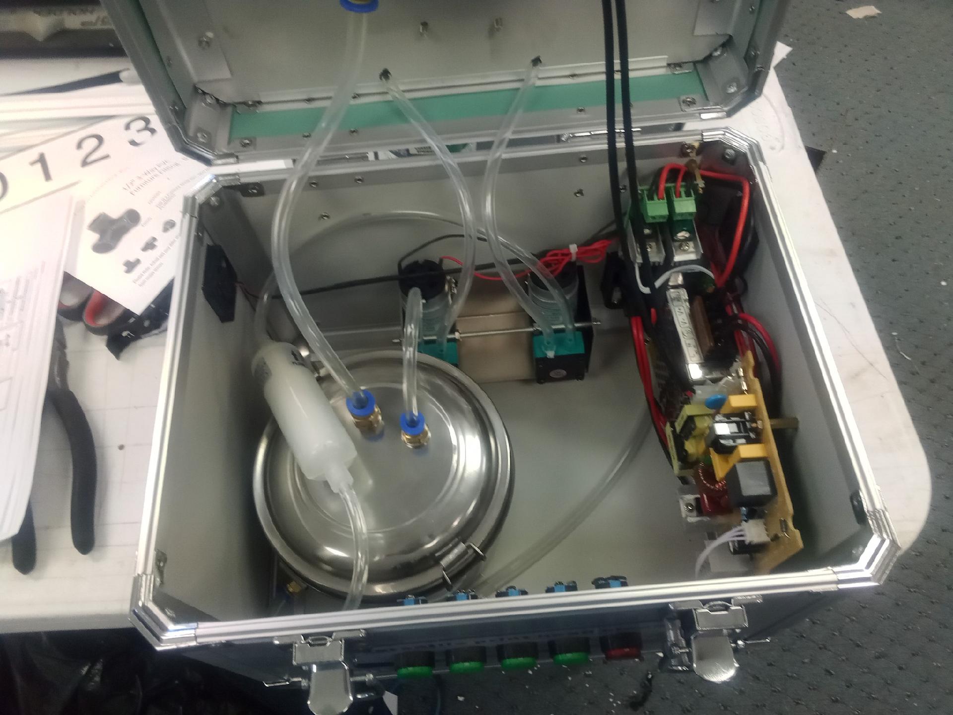

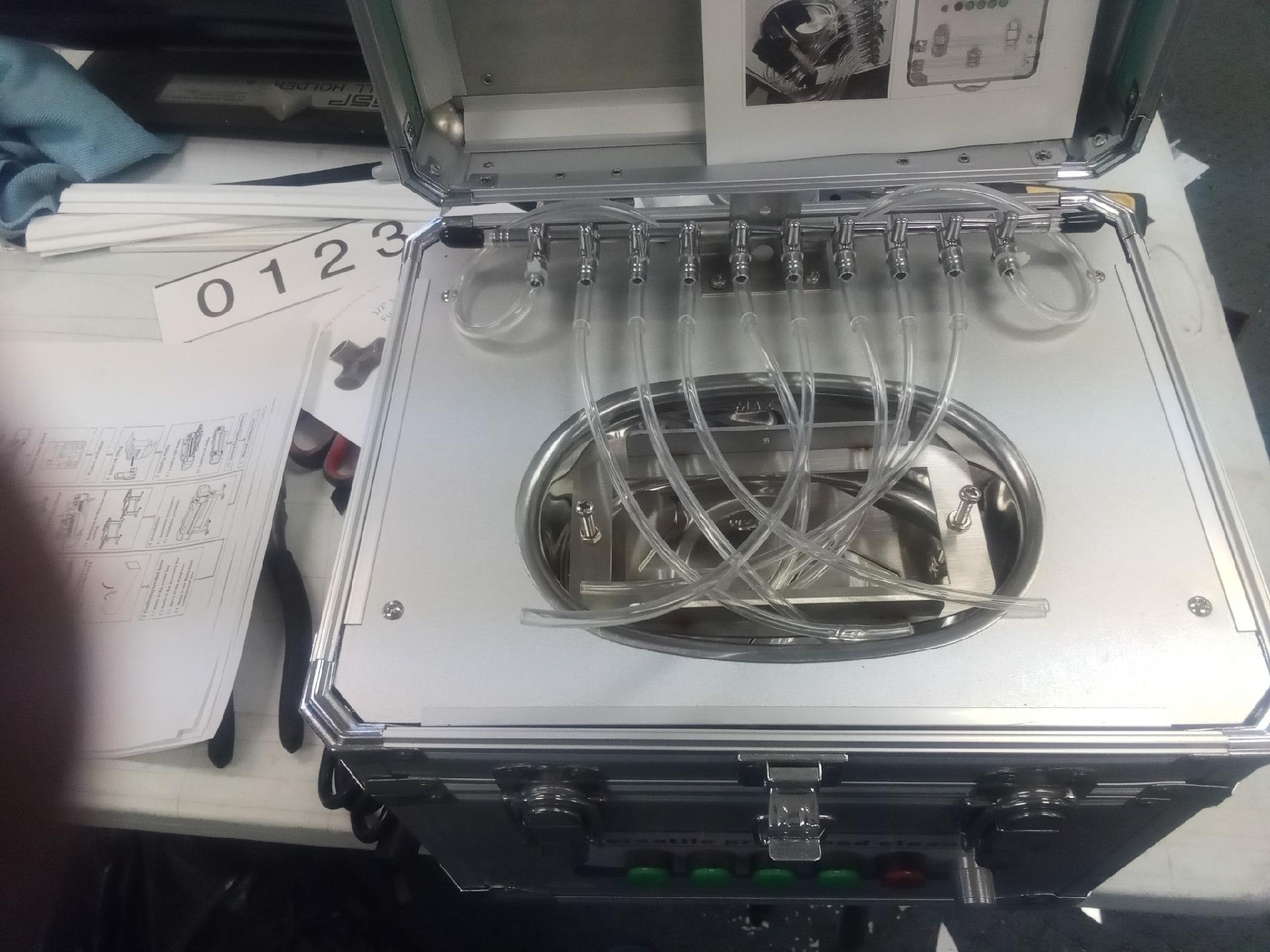

we bought a knock off print head doctor on ebay
netsol
bought a year or two back, on ebay
