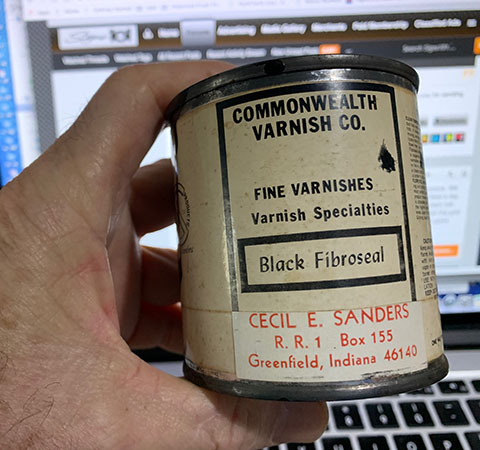

I found an old half pint can, Commonwealth Varnish Co./ Cecil E. Sanders (look at file). Good luck finding it.
