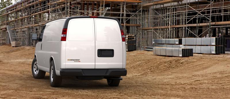

03_perspective_img_3.jpg I have always heard that it has to be laminated. It seems that Chevy would be in violation of the law for making this vehicle if we have to laminate. Lock them up and throw away the key.

That's a commercial vehicle. Not a passenger vehicle. For some things they have more lax regulations. (Because it helps with commerce)
And why would you put window film on a solid van? We are talking about glass, safety and visibility.
