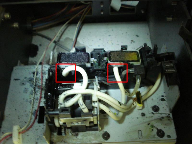

Here is what i'm working with...scary i know! So am i suctioning from the white tubes where it connects to the capping station, or from the hole in the capping station it's self? also i noticed in the tubes connecting to the dampers there is very little ink and air bubbles slowly moving backwards in the black, blue, and (or magenta?) light magenta. you would really be saving my *** if you can help me out : ) capping station.jpg

these two points will pull a vacuum.
it's not probably that you would be losing ink on all dampers at once, unless none of them are screwed on securely an straight. an air leak at the cap will cause the positive pressure in your lines to drop allowing th ink to drift back down into your carts. take off a damper and pull a vacuum on the line until it is about 2/3 filled. leave it hanging for a bit. the ink should stay in the line. if it empties, you have a leak at the damper. if the damper isn't securely on the head's manifold it will not fill into the head. broken manifolds can be an issue, but there's no way you have broken all your manifold nipples.
