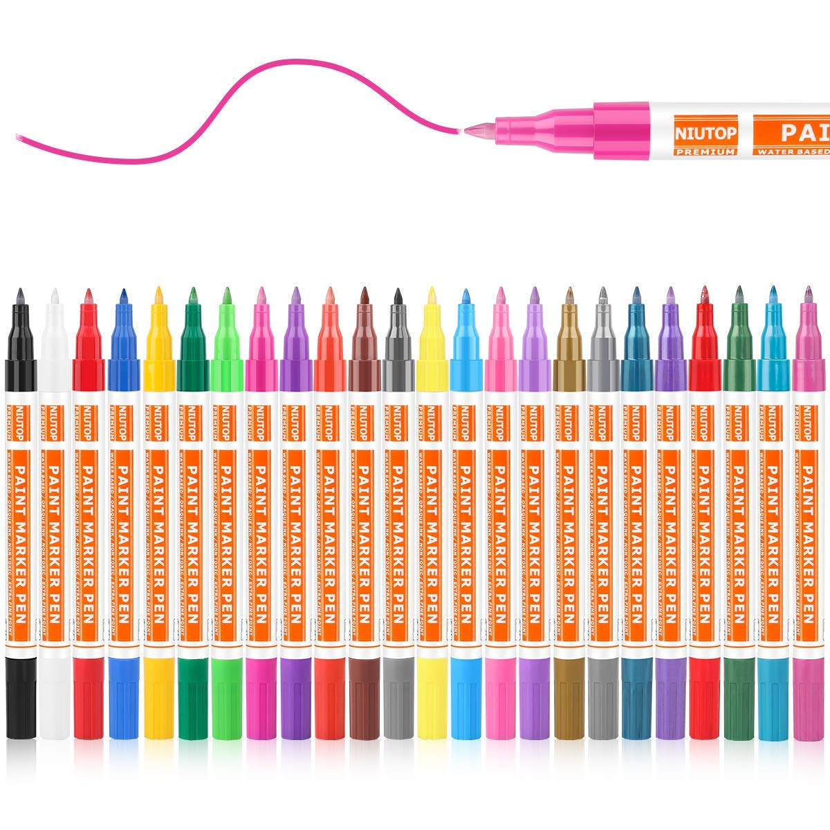

Andy D
Does nobody use paint pens like these?
Andy D
Those are just a vaporware scam, aren't they? i love the idea can't see it being possible to manufacture...
Now that I think about it, it does seem pretty fantastical...and it's not on Amazon.
Thanks for crushing my dreams Burg :(
