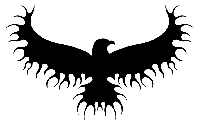

I just uploaded another video. No sound or commentary. Nothing terribly difficult. Keeping nice smooth curves requires proper placement and control of nodes. Anyone can draw curves but keeping everything smooth can be tricky. I think Illustrator's node controls are quite good once you undertand them.
The ending I cut off, mostly small edits and tweaks.
Done in Illustrator CS5 using a Wacom Tablet
About 18mb, slow downloaders beware
http://dl.dropbox.com/u/5144854/curvy eagle.mov

Wow, alt-clicking on the second control handle changes EVERYTHING. I had been forced to go back and use the convert anchor point tool after drawing nearly everything, because i never really grasped how to project the second handle to where I wanted to go next. that's awesome, thank you!:rock-n-roll:

wow! Thank you for sharing this. Like SAS said, I've learned something today, but I will still send my work to Eric...
