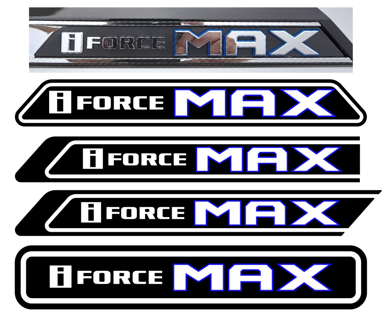

Prodim - new to me, but looks similar to the scanner/tracers that build 3d models. I think the photo idea will get you there.
I had a customer with a brand new Tundra come in - wanted something similar to the badge on the hood as a decal on the rear. I took a photo of the badge and sent him a few samples:
He said he liked the one on the top if I could change the color of the 'force' lettering to something other than black to make it easier to read...........................
Isn't the one on top the photo you took?
