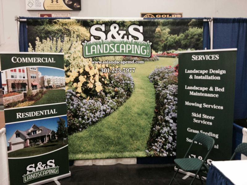

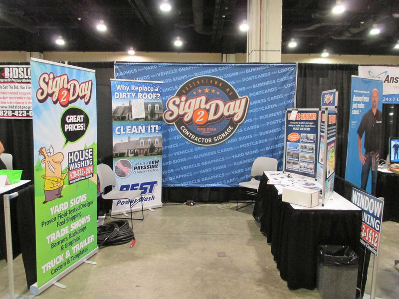

I've done one 13 oz. vinyl banner. (landscape banner below) Bad choice. Hard to handle and store and does not present as well as die sub on 9 oz. polyester. The die sub products are becoming more readily available and at a better price point than just a few years ago.
Please try to find a way to use a pole pocket and pole. If the show has pipe and drape, you should be able to use that to suspend your pole. Wire ties work well.
