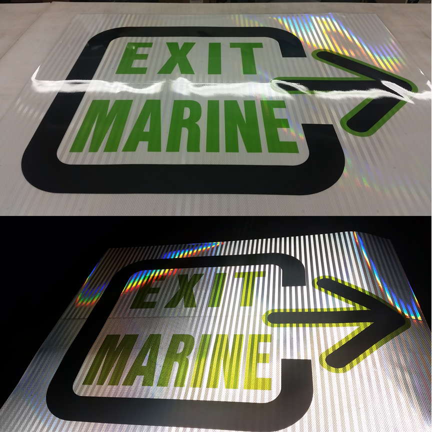

The HP latex have variable ink density. I'm getting ready to print onto some HIP right now. I'll try to take a pic and load it onto here.

So just got in a roll of the 3930DS along with the 1170 lam and printed a sign for a customer. After some tweaking our HIP profile on our HP570 it works awesome. The new 3930DS seems to be more pliable and goes through the machine very easily.
