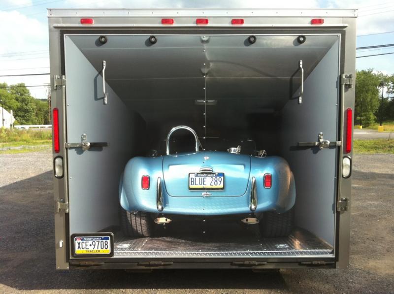

We whipped this out quick yesterday in time for the customer to hit the road for a car show.

Very cool, is that the photo of the actual car in the trailer?
Did you guy's take the photo of the car in the trailer yourself?
If so what kind of resolution did you use for the photo?
I like it!

yea lets hear some details my old man is always wanting me to do this with his race trailer...

Have done one like that before and have taken 2 others off after their insurance told them that they would not cover a theft of the vehicle if someone broke into the trailer. Also was told that it was illegal to replicate a state license plate at the exact size.
Looks good though

The customer (my best friend's Dad) gave me a disc full of photos of the car in the trailer as well as photos of the empty trailer. These were just from a regular old digital camera, nothing special. We blew it up and printed to scale from a flattened .tiff @ 72 DPI on our Mutoh 1614. Normally, I'd have done this on Orajet 3651 or 3551, but I had a short 48" roll of IJ180V3, so I used that. There was very little waste, as the seam in the metal was almost in the middle and we printed vertical panels so there's no seam in the vinyl. The inside sides of the trailer are actually raw plywood, so we tweaked that.
CSDD- I feel no differently about insurance companies or the government in this scenario than I do in any other, but I can only properly express that in NHB ;) What if the trailer actually had no rear door, or the car was on an open trailer? Stupid laws & policies.

Impressive that the customer supplied the photos and was squared up nicely to the trailer when they shot it. I have a hell of a time getting people to shoot squared.

Well, it was my best friend, so he knows how we do things. Also, he gave me a disc with about 40 pics on it, so we just picked the best ones.

That thing looks great.
The attention given to the shadowing on the hinges and handles is fantastic. It's the little things like that, that sets it apart from just a run-a-the-mill wrap.
V-E-R-Y nicely done and executed !!
