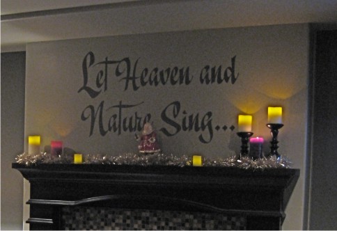

We did this with Phototex. Taped with R-tape. Took alot of squeegee pressure to adhere to the image and remove from the backing. Had to carefully remove the R-tape to leave the image on the wall. Definitely not something I would give to a customer to self install.
