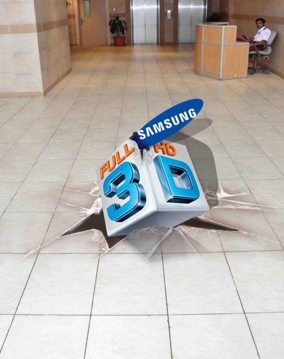

so weird question but why the need for translucent vinyl on the floor? unless the floor is lit from the bottom i don't see why
Most likely a design need. For things such as shadows to show through and look vaguely realistic on the floor, you would need translucent so you won't have a white background. Such as the graphic attached.

make sure you're CLEAR on what they're actually asking for with transluscent vinyl. Sounds like they want some sort of layering-effect, that allows you to see beneath it... so you're actually looking for a tinted vinyl or printed on clear.
...and pretty much any cast vinyl will allow you to epoxy over it.
