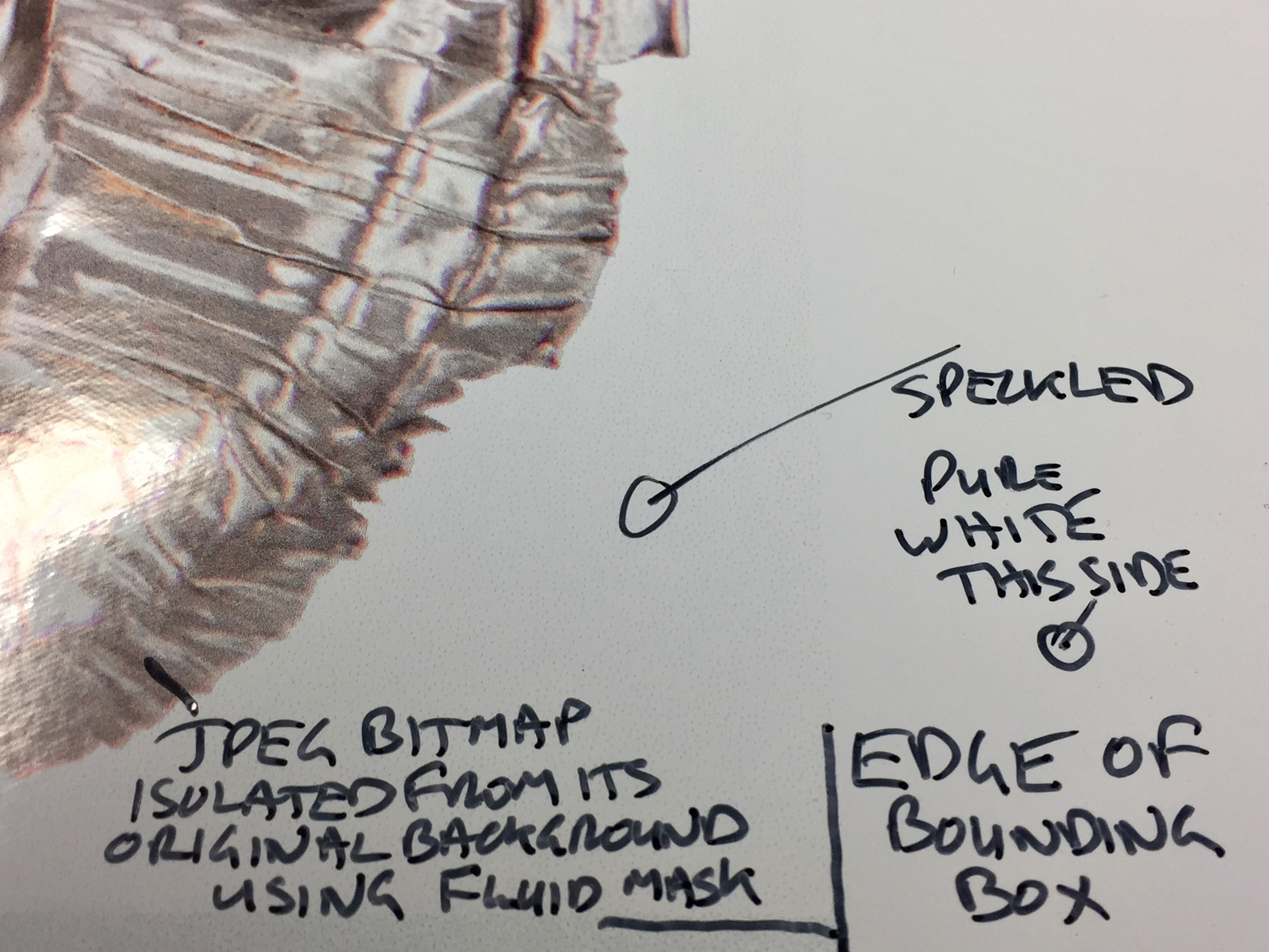

I’ve been through every option in Signlab trying to isolate an image from a jpeg and and print it on a pure white background. I’ve used fluid mask to isolate the but I want from the jpeg which it does beautifully, but when I print this inside a larger white rectangle.... I get a very faint speckled box round the cropped jpeg..which you can just make out on the final print. I tried printing 2 white boxes with a black hairline one in rgb and other in cmyk... both printed with a very faint grey speckle .

Well feeling refreshed and ready to tackle this problem again ! I’ve attached a photo which if you zoom in on you’ll see the speckled area between the bitmap and the bounding box.

Tried that Gino.... when u zoom in to edit the speckles... they are invisible. Even when u use the eraser tool it has no effect
