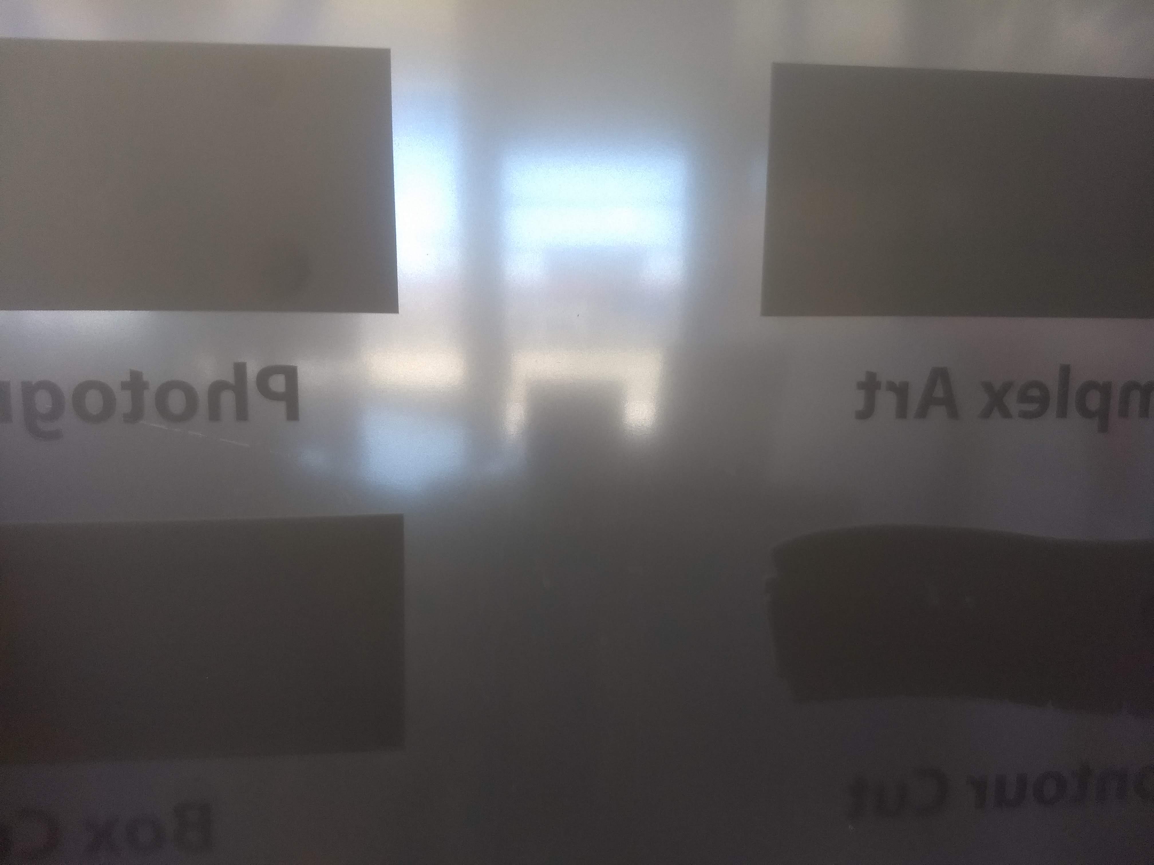

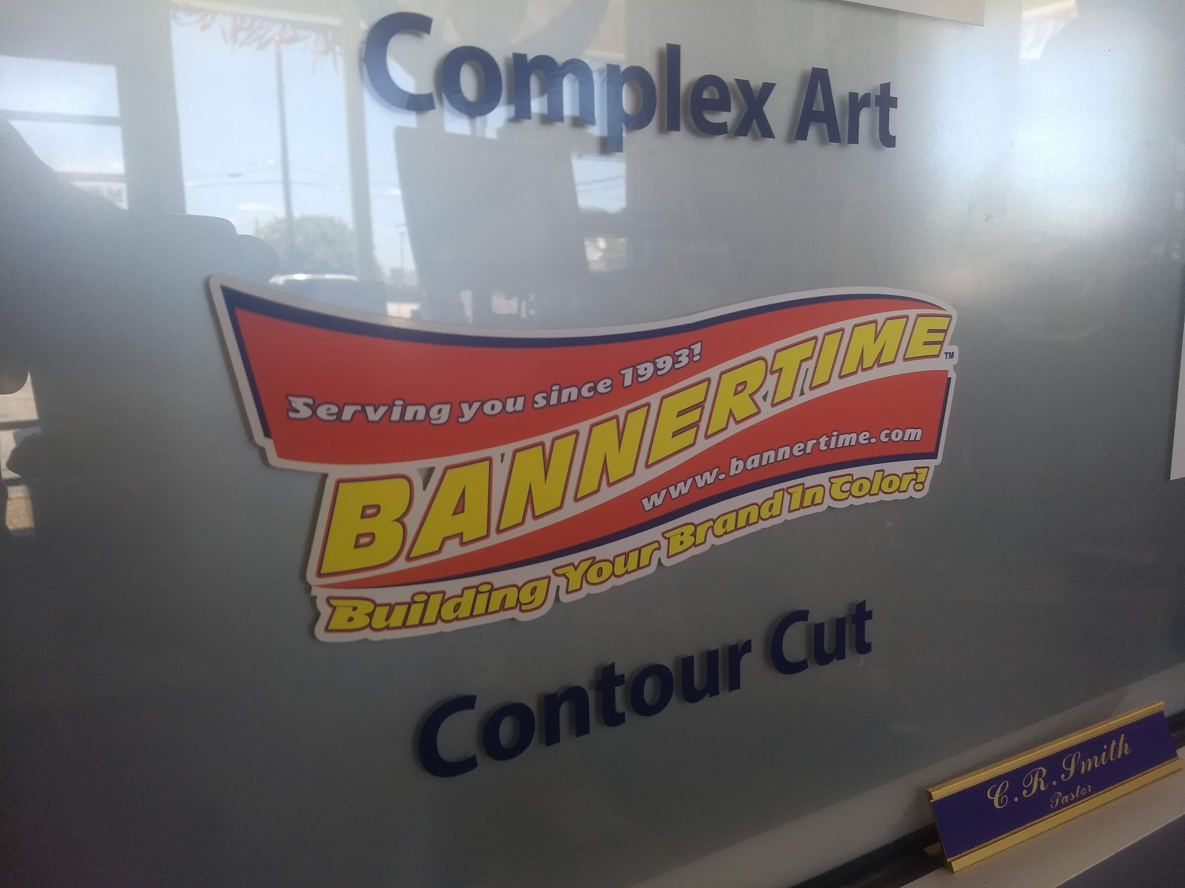

Avery made a metallic silver that was partially translucent. It kind of looks like etched glass except it's regular vinyl. Very similar to Briteline's silver but a tad darker.

yeah.. I'm not sure that a translucent is going to work over a reflective backer. I have some pretty thin silvers here, nothing really "works".
