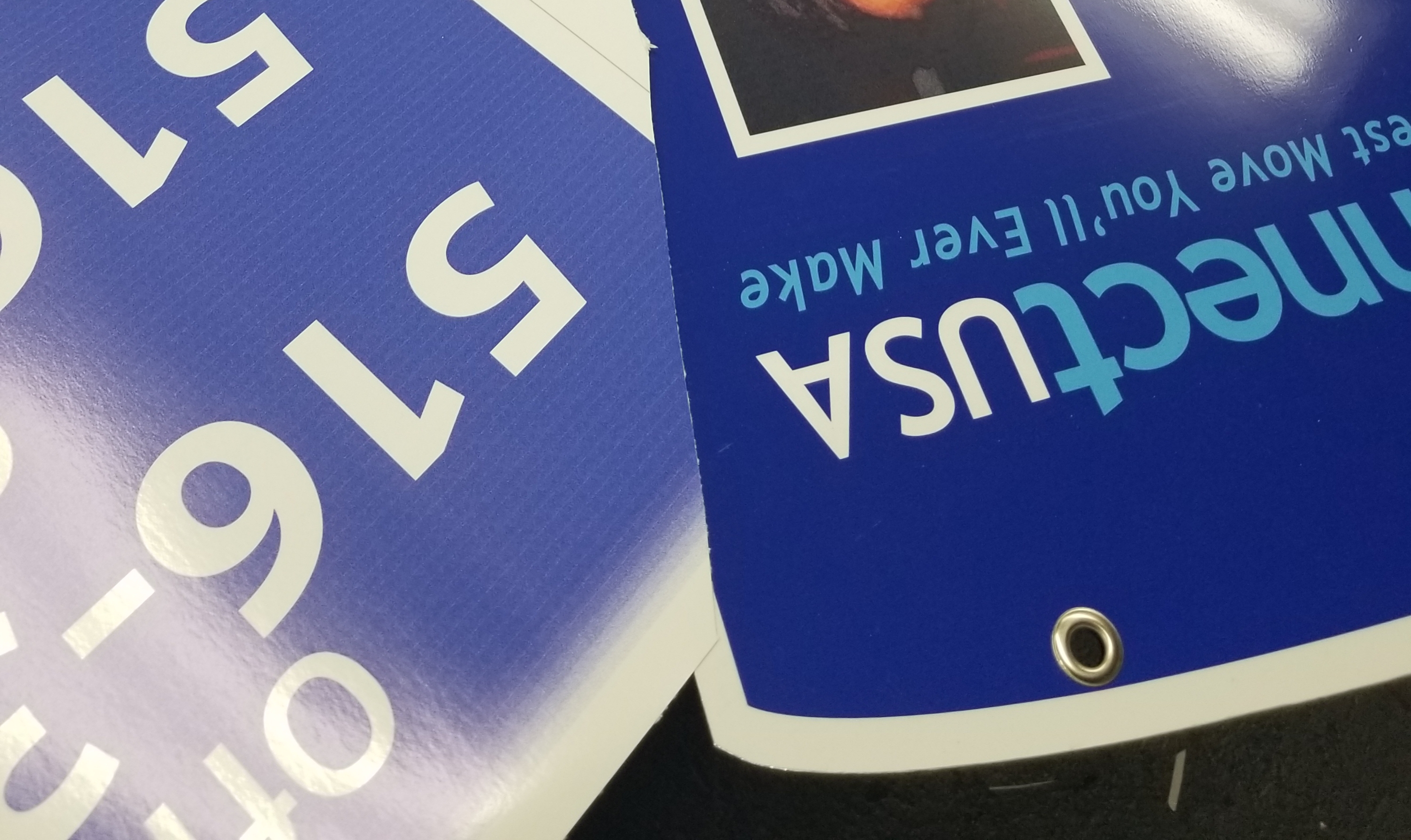

Then my coworker tried to print stuff that we usually print and now the color is so far off. He thinks I changed something in the print settings at this point I wouldnt know.
We tried going back and printing a preivous rip'd job from the other week to see how it prints and thats messed up as well.
If it helps I changed settings like preceptual vs relative colorimetric [in art app] and played with individual ink levels in versaworks.

Any help is appreciated, I feel like I'm flying blind and messed up the thing. I've attached pictures to show a print compared to what its supposed to be.

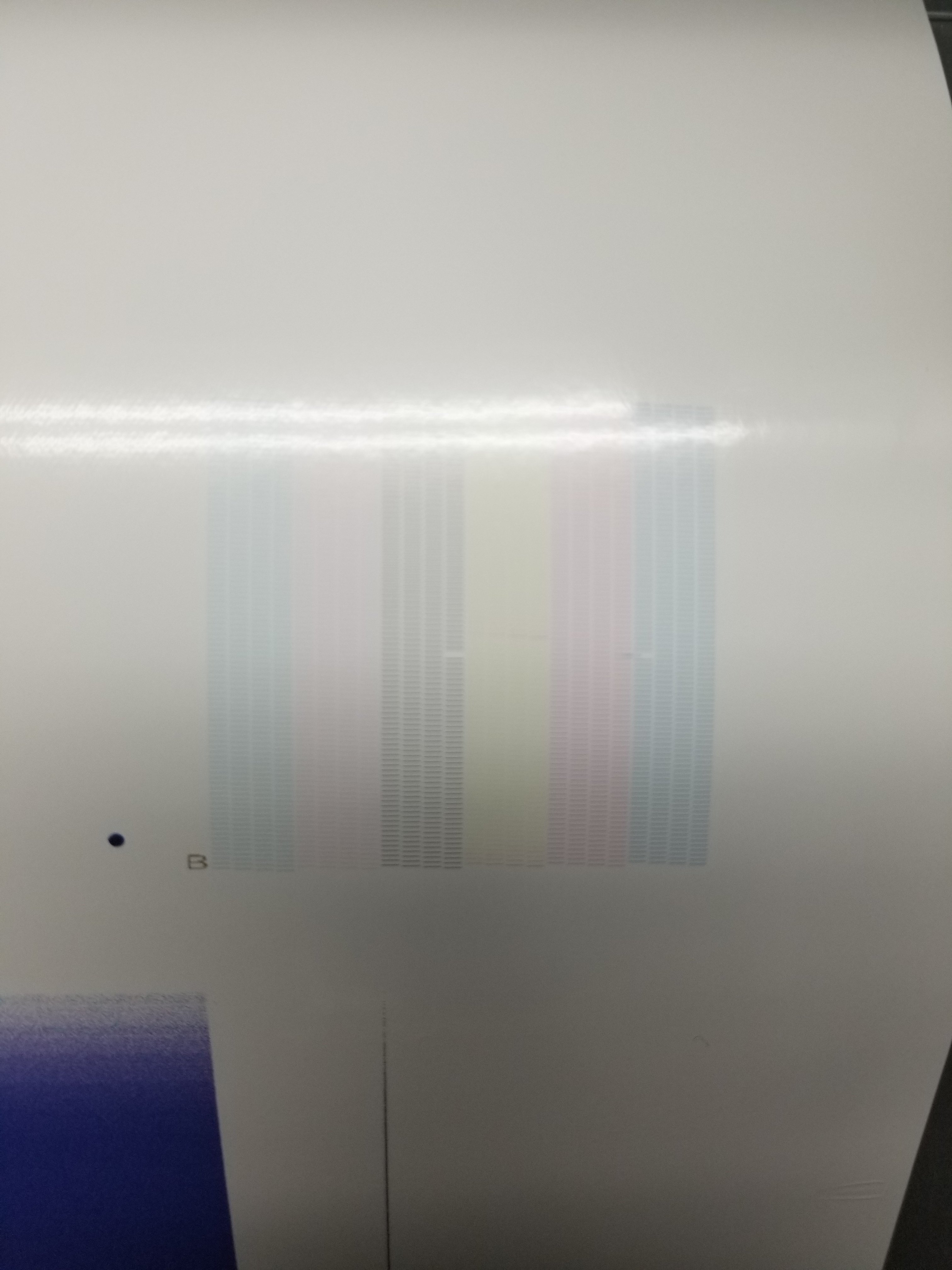

As FrankW asked, please post a nozzle test.

If everything was printing fine and then there was a sudden change in color, on both new and previously ripped files, it is most likely the printer itself, not the software. The best approach is to first insure the printer is printing correctly. So let's see a nozzle test print and go from there.

I got a very faint nozzle test. Its like it is printing at half saturation?
Sorry about the glare.but its what we sent to our tech and it promptly got tossed. We're only using print head b. The tech set that up for us last time he came by and we're def looking to get head A replaced.

It would make sense you are having color issues running 1 print head. The profiles are designed with 2 heads being used. So doing an overprint with 1 head would give the same results as no overprint with 2 heads.
I would be curious to know what the tech did to have you running with 1 head. Please enlighten us.
