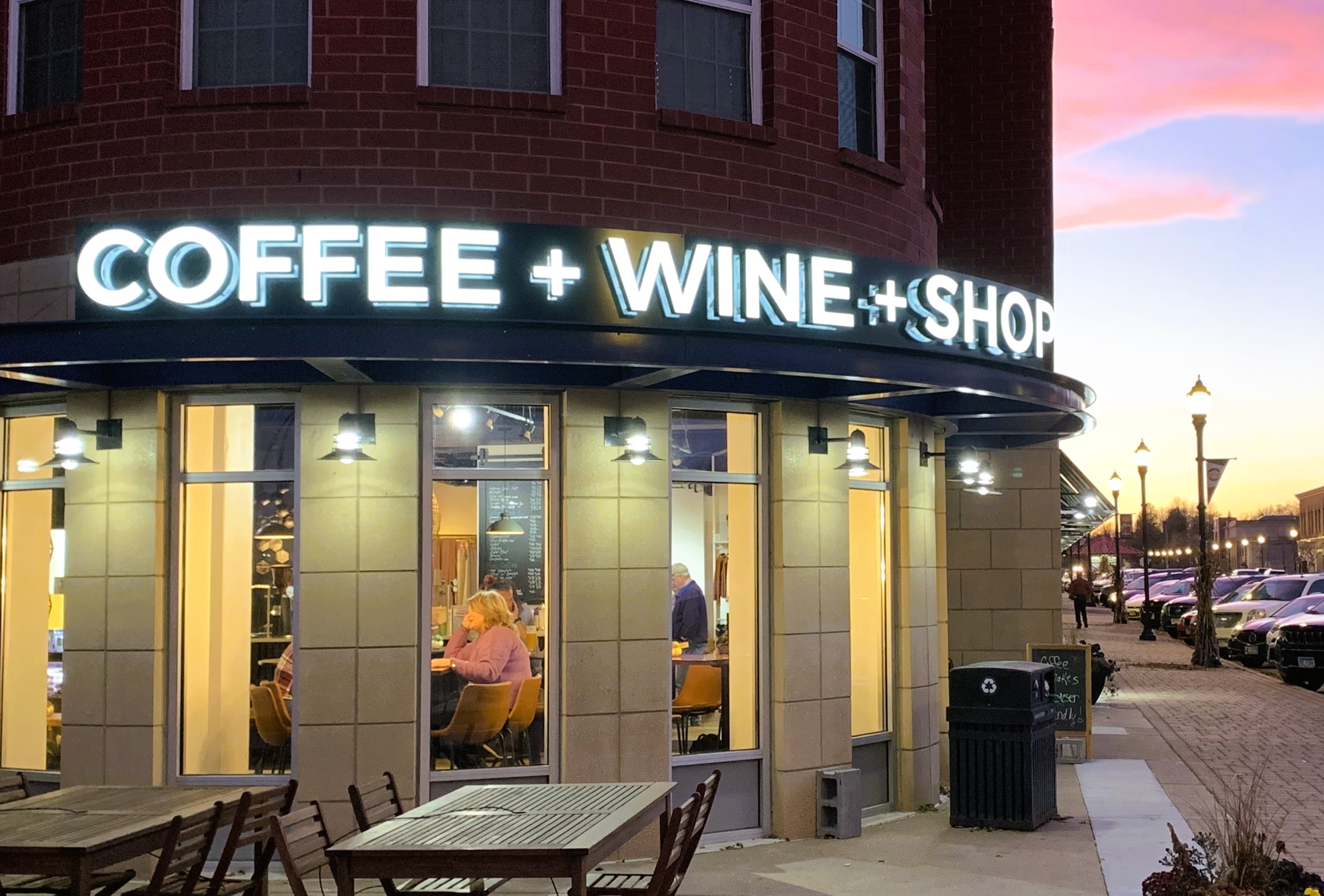

www.jigsign.com
Thanks Evan! Let me show off some of your great design and installation work up with the Minnesota sunset in the background---after all---fabrication is just one small step in the whole process.
