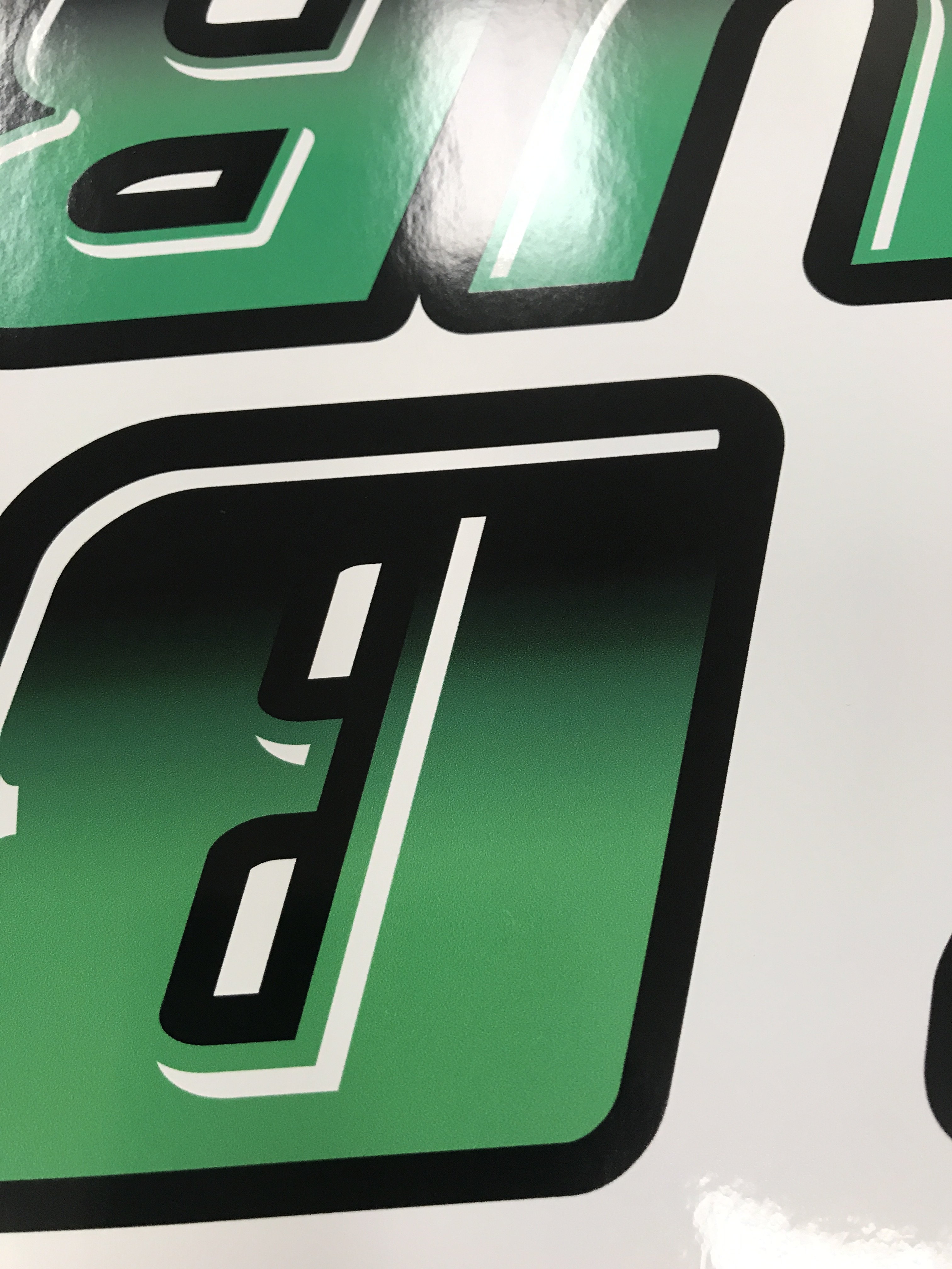

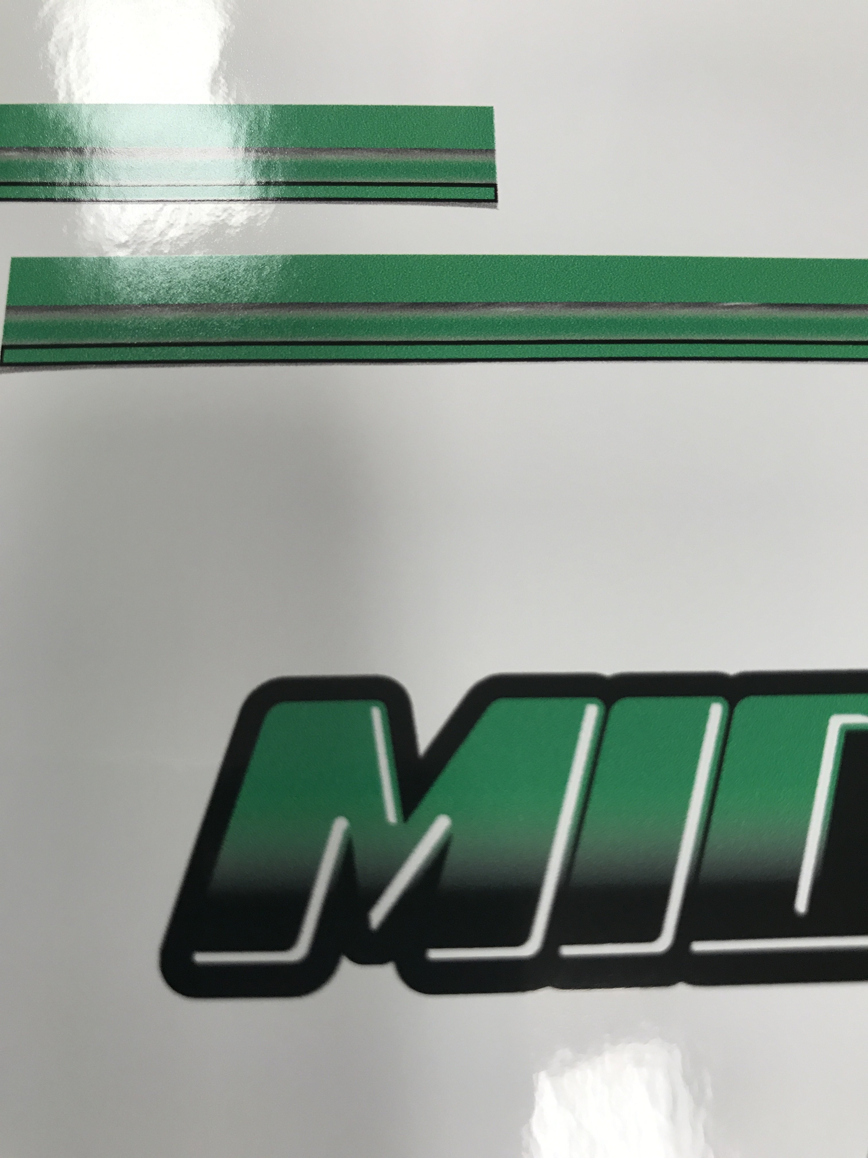

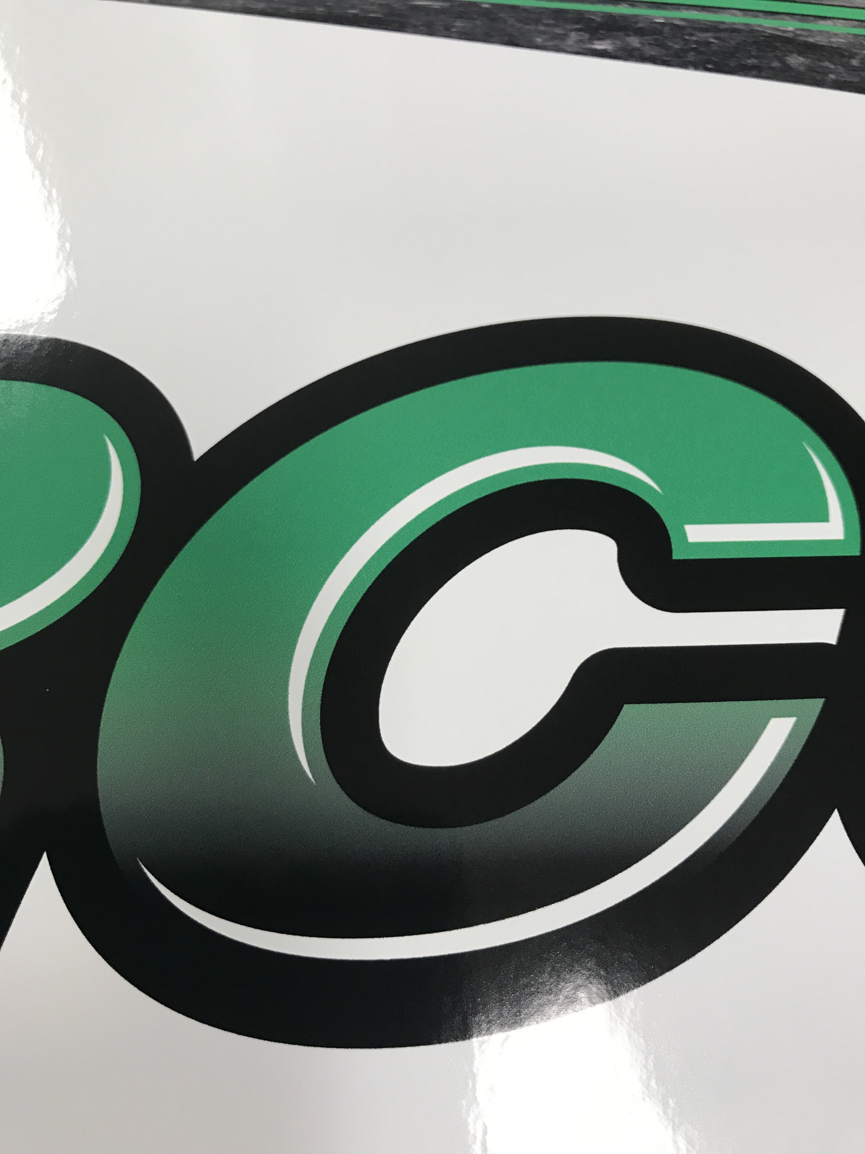

altereddezignz
As you can see from images the one picture that has a nice black to transparent is ok. The next is the same exact black to transparent but there is grey there in middle. The next one is the same but black to green. Any ideas. Have tried cmyk to cmyk. Rgb to rgb. ?

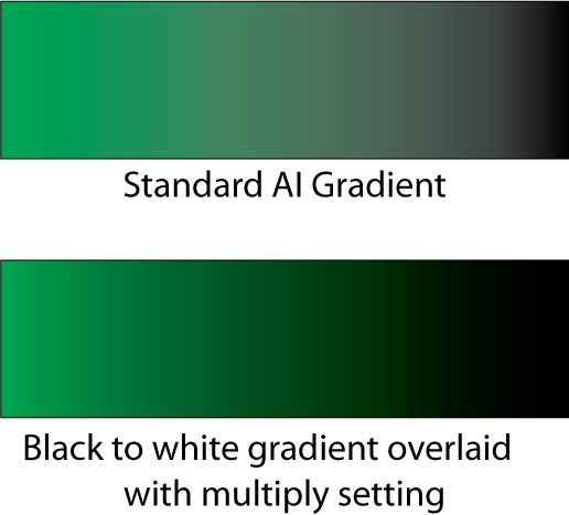

Solventinkjet
DIY Printer Fixing Guide
Make the object you want to have the gradient solid green and then copy and paste the same object in front of that object. Make a black to white gradient and then set the transparency setting to, "Multiply" instead of, "Normal".
