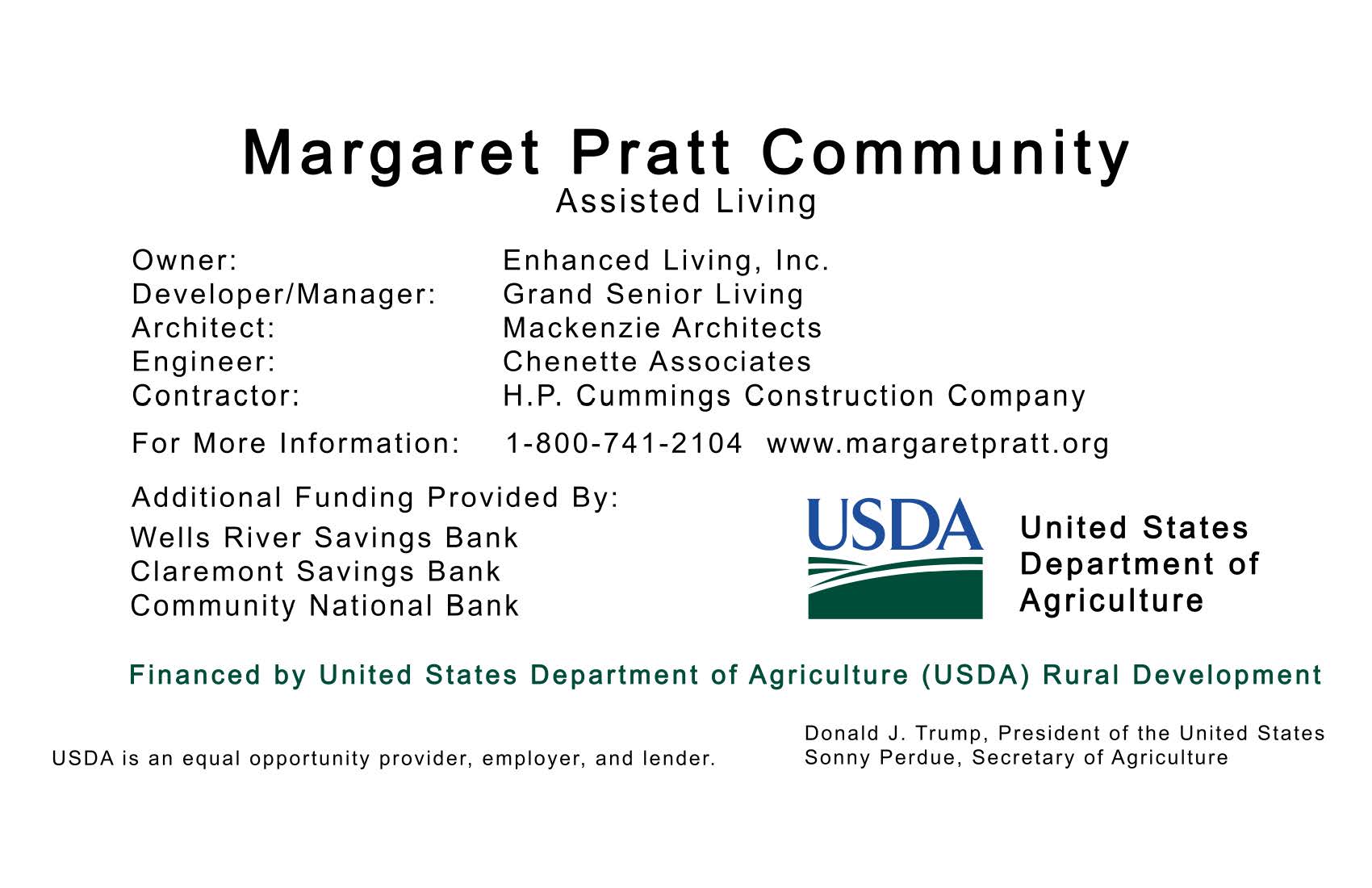

Just got a RFP for a Dept. Ag construction sign, and if we get the job we will have the pleasure of not only cutting 45, prez of US... but also Sonny Perdue, Sec of AG. So much winning!
Anyway--- they want standard plywood 4 x 8 (Marine Grade or equiv) and this sucker has 600 characters and a USDA 2-color logo. We would do it on factory prepainted 1./2" plywood, 1-sided.
I am sure someone will quote it cheaper than me ( I used to hand letter 400 helvetica characters a day for a couple hundred bucks back in the 70's)... but I am wondering what something like this in applied vinyl should quote for in November 2017.

Doing it that way, I am out of pocket $250. All I need to do is spend an hour admin & setup, then another laying on the controltac (using a prepainted 1/2" plywood RTG panel). So what? Like $700 to make it worth my while?
OK- now they want me to quote vinyl... out of pocket say $175.
600 characters applied $350. Still $700 (at least) to make it worth doing.

So I notice that nobody is talking about computer cutting 600 characters and a 2-COLOR logo.
Even if you can get a $75 board... what do you charge for a tight packed vinyl applcation?

edit: after seeing your diagram, you'd have about 1/2 hour of cutting and maybe 20 minutes of weeding. 5 minutes to tape it and maybe 15 or 20 minutes to put it all down. Still..... no $700 sign. How many are they requesting ??​
