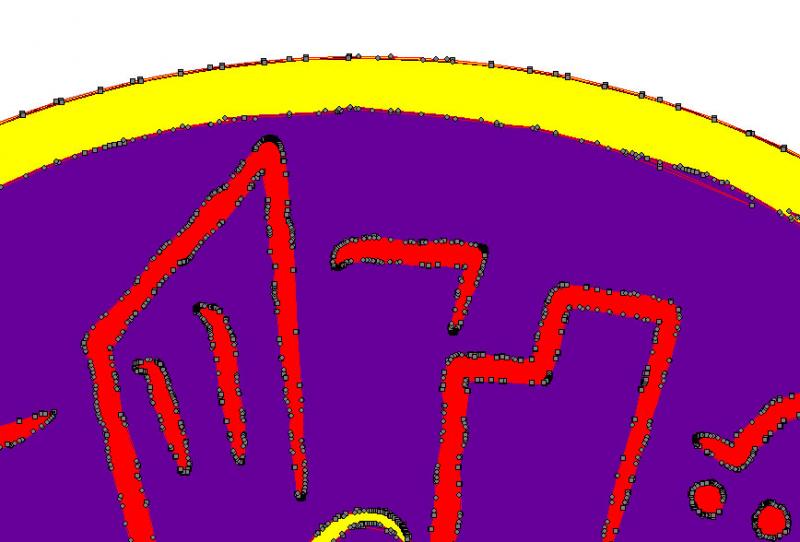

Sign_Boy
Check out the nodes on this thing now.....:ROFLMAO:
peavey123
Try this. Convert it to a HIGH quality jpeg, and run an autotrace on it. Believe it or not... it works.
...man I get a file like the one sign boy posted every couple weeks...why didn't i think of this?! thanks, Flame!
flyinhawaiian968
Corel export filter has been doing this for years and years! Its the settings when exporting that does this
IIRC, when they export as an eps or .ai file, they've checked the simulate complex filled curves or simulate outline effects, not sure which one does it. I think it also happens when fills are gradations, but don't recall.
Have the client uncheck those boxes and save as an .ai file, it will pretty much open with little or no issues at all, or sit there and weld all the pieces together. Sometimes its just easier to re-trace and clean it all up on your own though.....

Thanks for the info, I'll have to remember to tell Corel users that next time. I don't know much about Corel.
