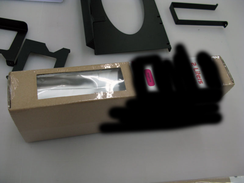

Sneaky preview...... mmmmm 2 chunky liters of ink in a bag goodness. :smile: Thats darn near pushing wide into grand territory on ink size for a single color. Going to take me a bit but I'm taking photos and will be posting my full review very soon. :thumb:
Guess the setup and win a cheesy prize. :Cool 2:

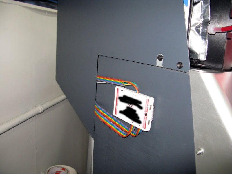

So - the choice was made - no need to create all new profiles, excellent inks, excellent company that does stand by their products. The bulk system is Triangles full Eco Bulk system. It uses 2 liters of ink per color which comes in cardboard boxes. As installed it is effectively a sealed ink system with the ink in a bag which collapses as it is used just like your printer was designed to work best with. I got the Eco Bulk Plus system which also includes Triangles EasyresetV3 which is a fully automatic permanent chip resetting system. Unlike chips themselves this actually connects to the printers chip connection board behind the cartridge slots where it gets it's power and interfaces directly with the printers mainboard.

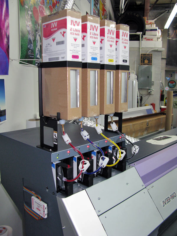

A picture of a whopping 8 liters of ink loaded on a JV33.... I will post again soon going much more in depth on how the system installs and works along with my thoughts on it after using it for a short bit. The bit on the left end of the printer is the Easyreset which has a button you can press to make the printer go to all 9's on ink levels. You could realistically mount that inside the back and never use the button. Simply powering the JV33 off and on again also does the same. Also notice - no long cartridges - so no need for that big support shelf for them which I promptly removed.

Well - to be honest if you are comfortable doing something about as complex as say - removing the head carriage cover and changing your own dampers or capping station top then installing this is simple.
Took me about 30 minutes in total. That being said - their ink train warranty paper does require that an official dealer "certified" tech do the install. The instructions which are pretty well laid out and self explanatory does want you to flush the entire printer during the changeover which I can understand if you are running any other ink. However the instructions do want you to flush even if you are already running Triangle ink which I dont really get, nor did I do.
There are a couple of minor quirks I'm not too fond of. One being that this only uses 4 of the cartridge slots (this in itself I'm fine with) but they do not have any method to fool the printer into thinking at least those unused slots have something in them. As a result - (and the install guide even mentions this) your printer beeeeeeeps every 5 minutes complaining that 4 cartrdiges are missing - of course those 4 slots have their red lights on all the time too. Does not hurt anything or prevent printing in any way but somewhat annoying if your printer is nearby you all day. I found that I can simply stick 4 empty cartridges (does not even matter if they are full, empty, or even the right color or type of ink) in those slots though and it shuts up but this comes with a caveat. The printer could try to switch to those since it thinks they are now full and in place.
I am working on a solution for this myself though and will keep this updated with what I do.
