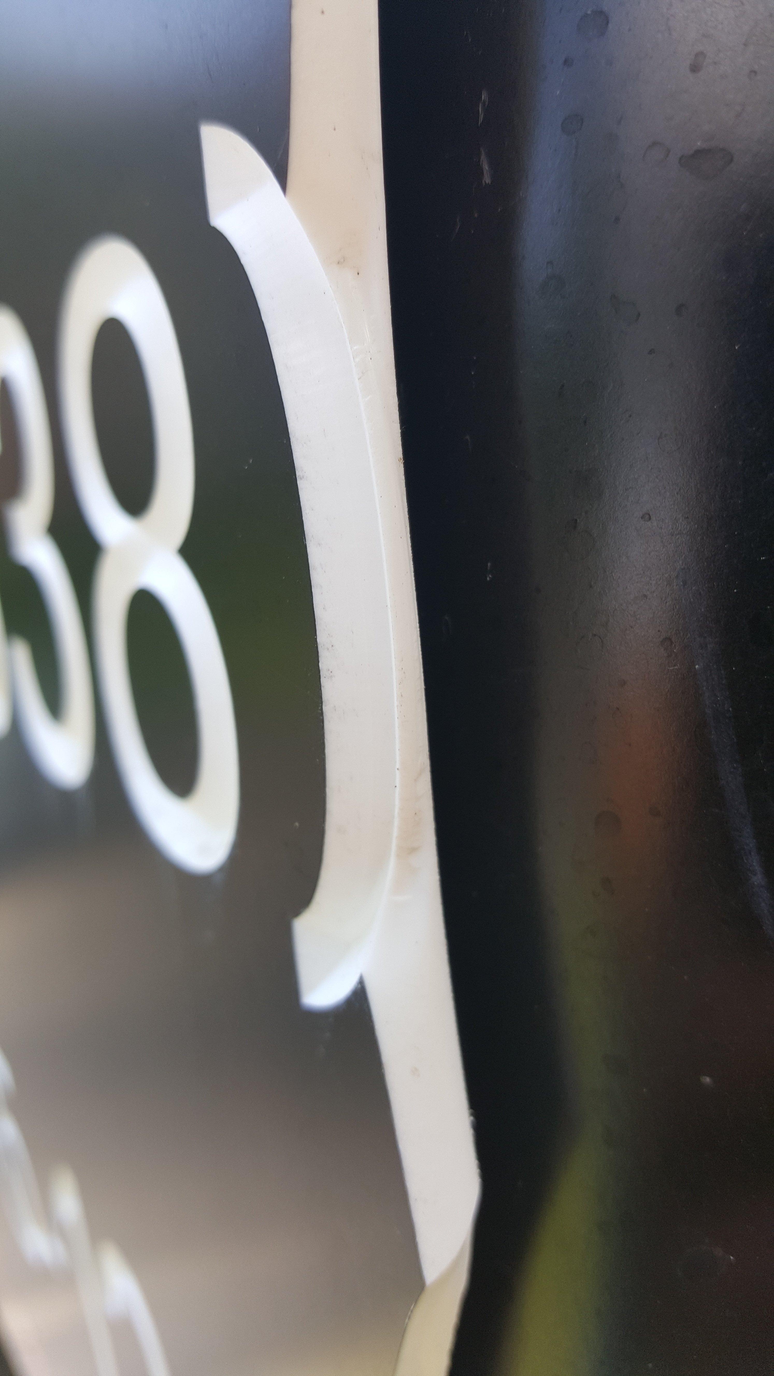

6mm, It has the rigidity of PVC pipe... looks like we have some disagreement on whether it is type 1 or type 2.
Anyone have a brand name I can spec since we'll be outsourcing?
It's definitely not colorcore.
Image shows edge, as well as routed 1/8 deep letter. You can see why we're replacing lol.

eahicks

It may be Type II actually....I think it is denser than Type I
ChrisN
Sure looks like solid PVC. The glossy face foamed pvc doesn't like that inside, not even the 6mm sheets.
You might want to look KOMADUR PVC from Kommerling. It's a Type I PVC and I don't think it's foamed. (I haven't actually seen a physical sample of it though.)
