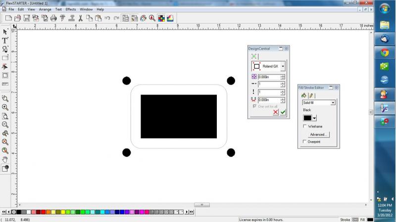

Interesting how the seller blocks out the Flexi version being used as well as the cutter driver... I am installing Flexi STARTER 10 now and will see what I can find.
CS-SignSupply
Within FlexiSTARTER 10, you can import an image or vector file, use the Contour Cut feature to create the contour cut... then create the Contour Cut Marks (for most any brand of cutter). Send the job to print. Load the print on the cutter and go from there (depending on your cutter features and contour cut marks).
Screenshots are available if needed.
There is no direct upgrade path from STARTER 8 to STARTER 10.... simply purchase new STARTER 10 for $395

CS-SignSupply
This sounds like just what I am after. Can I for example import a image file, add a contour cut line outside it, and tile multiples on a sheet like you would tile multiple similar items in production manager for cutting?
Also, can the program add registration marks for Roland cutters, so you can use the OPOS eye for registration?
If flexistarter 10 can do this, I would be happy to place an order for it right away.
No option for Multi-Copy, but you can copy and paste
Roland Registration Marks for GX, GX Pro and SolJet/CammJet
As for it being PRO without a RIP.... loooong way away from PRO.

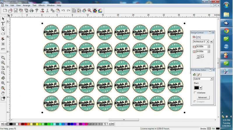

No problem using copy and paste within the actual workspace, as long as I can make for example 30 rows of 10 printed decals to make 300 copies, send that file to the Epson Stylus Pro with registration marks, print, laminate and load the sheet into the GX-24 to make the contour cuts using the optic eye for registration/alignment?
CS-SignSupply
Imported PDF, Created Circle just inside of original design, set to contour cut, copy and pasted over and over, selected all and created Cut Contour Marks.
Haakon
Thanks, that looks great! You have my email now (the one I sent my sample file from), if you can have a copy of Flexistarter 10 shipped to Norway, just send me a mail about what information you need from me in order to arrange what is needed. :thankyou:
