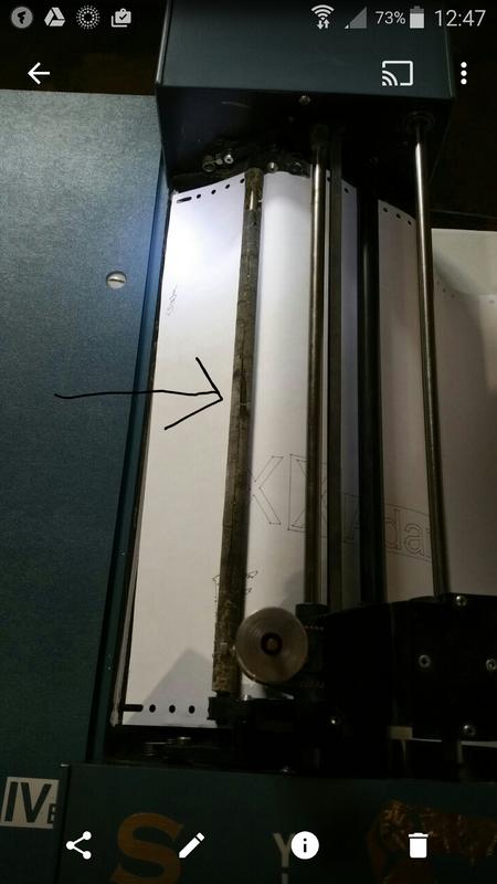

Thanks a million, again, Fred!! You saved my life once before in helping me get this set up years ago and again now. I opened Production Manager like you said, selected the plotter I'm using now, changed the port setting to 4 where the serial converter is and.....it worked!! I'm cutting mask again. This old 4b is still amazing, sprocket fed, accurate cuts, no problem cutting the thickest mask, works every time. Now, if you can tell me where I can buy a new bale arm for it (mine is crumbling), I'm set. Thanks again, Fred, for your help on this.

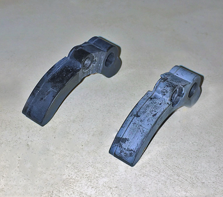

:pops_blinking: I have an old, used pair that isn't crumbling that is free to the first Premium Subscriber that asks me for them.
Fred Weiss
Merchant Member
Sorry, I used the wrong term....probably roller is the name.
Yup ... that's the bail roller. The rubber eventually goes bad on them, usually melts. If it's dried out and crumbling, try wrapping it with a piece of cast vinyl cut to size. If melting, then scrape the rubber off down to a clean metal roller, measure the diameter of the shaft, and get a piece of polyurethane tubing to replace the rubber. That particular part doesn't do anything that requires a precise fit.
