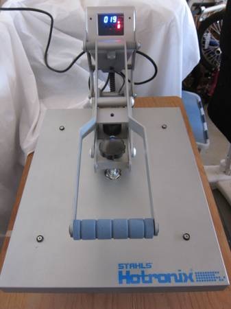

Thanks for the feedback...I bought the Hotronix unit, it was in mint condition. He threw in several (large) rolls of heat transfer vinyl, too.
Just one step closer to retirement.
