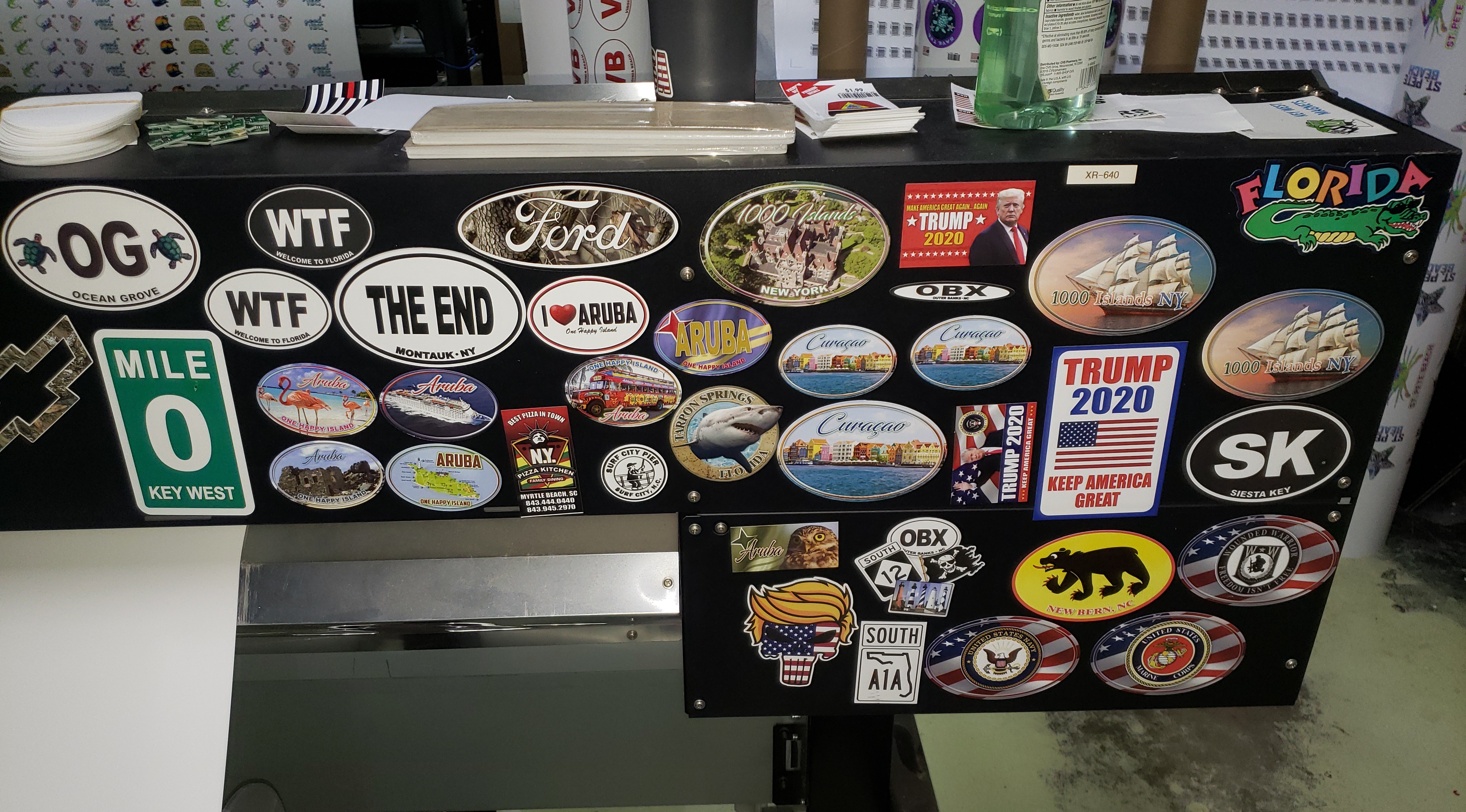

I just recieved another 60 - 30"x50' rolls of magnet material.
I will be printing all shapes and sizes on a Roland XR-640 solvent ink printer then cutting on a Graftec FC2250.
My suggestion in having great results is to take your time and make sure everything is feeding straight and set the head height to high.
