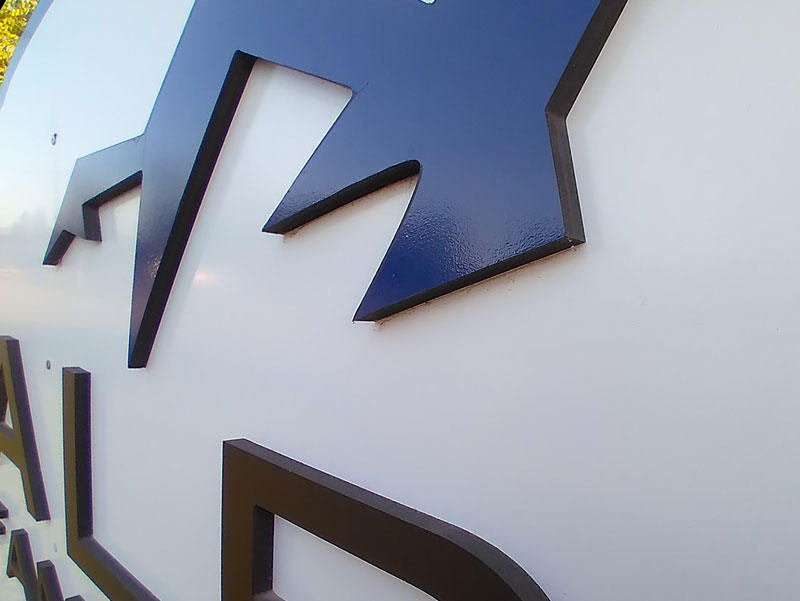

Is it ever a good idea to use routed PVC/Sintra pieces for an exterior dimensional sign? All my research leans toward no, but then I came across this sign in my neighborhood that appears to be 1/2" black PVC, some faced with blue vinyl, adhered to a sheet of ACM (see pic). Adhered, not fastened, there's no screws on the back. PVC is known to get brittle in cold temps and contract/expand. I'm currently bidding on an exterior wall sign and looking into fastening 1 inch thick painted PVC letters to a substrate. My sign is north facing. Considering painted PVC because I don't want the glossy look of acrylic for this sign.

I'm not sure if this is still available, but years ago I would use a 1/2" PVC that was exterior grade, supplied by Harbor Sales. You could probably get away with the interior grade if you are painting the faces and sides of the letters though. I've done signs exactly like the one in the pic, (vinyl face letters on ACM), though I've screwed the letters from the back AND used VHB tape. I've used interior and exterior grade PVC, no issues that I know of. I probably wouldn't go less than 1/2" thick though.

There are different grades of PVC, some for interior and some for exterior use. Black PVC is typically an interior product but different manufacturers may have an exterior Black PVC. What you are proposing is a very viable solution, PVC can be a very appropriate choice for exterior signage. Also, Sintra is merely a brand name of a particular PVC.
