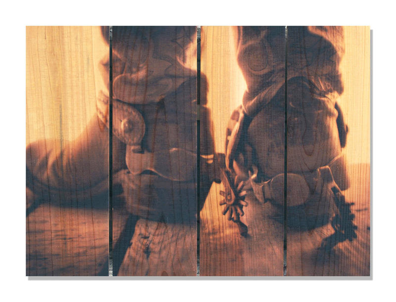

I think 1.5-4 mm (.06-.16")would be acceptable but .01" seems pretty sketchy for this stuff. Attached is an example of what I am talking about.

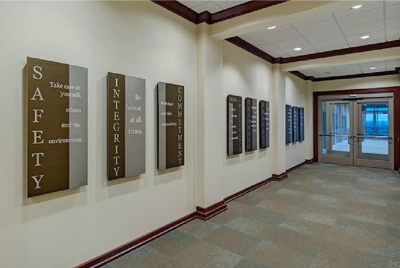

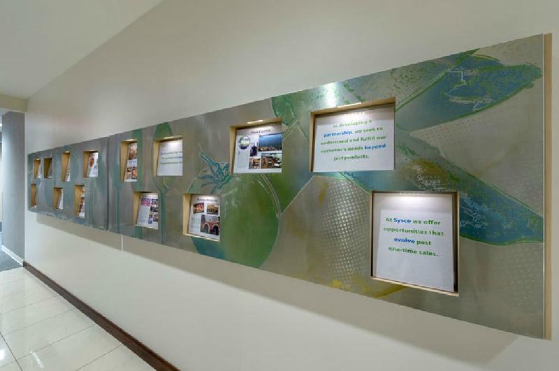

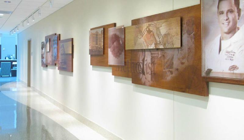

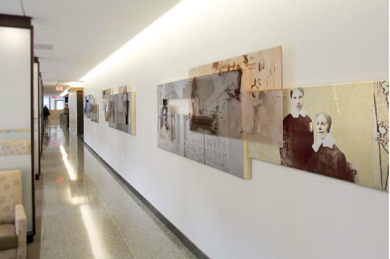

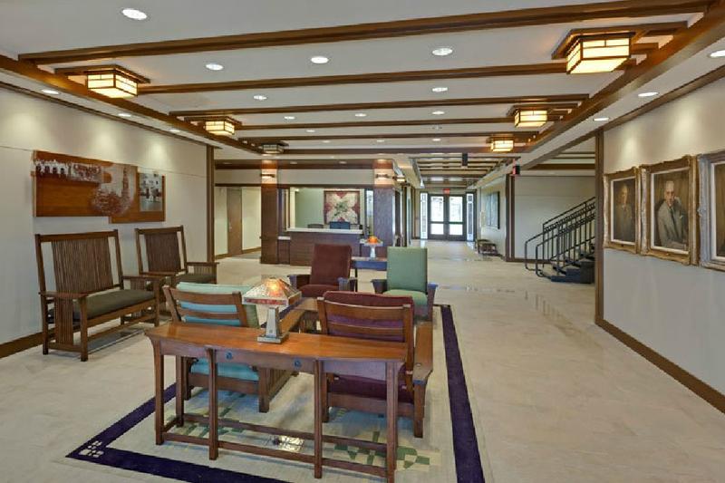

rubo's right. veneer and also .020 petg easily fits through a standard solvent printer. solvent inks print beautifully onto clear acrylic lacquer finish. and solvent inks print much nicer with high head height print gap than
uv inks.
all these projects were done with an old Mimaki JV3.
