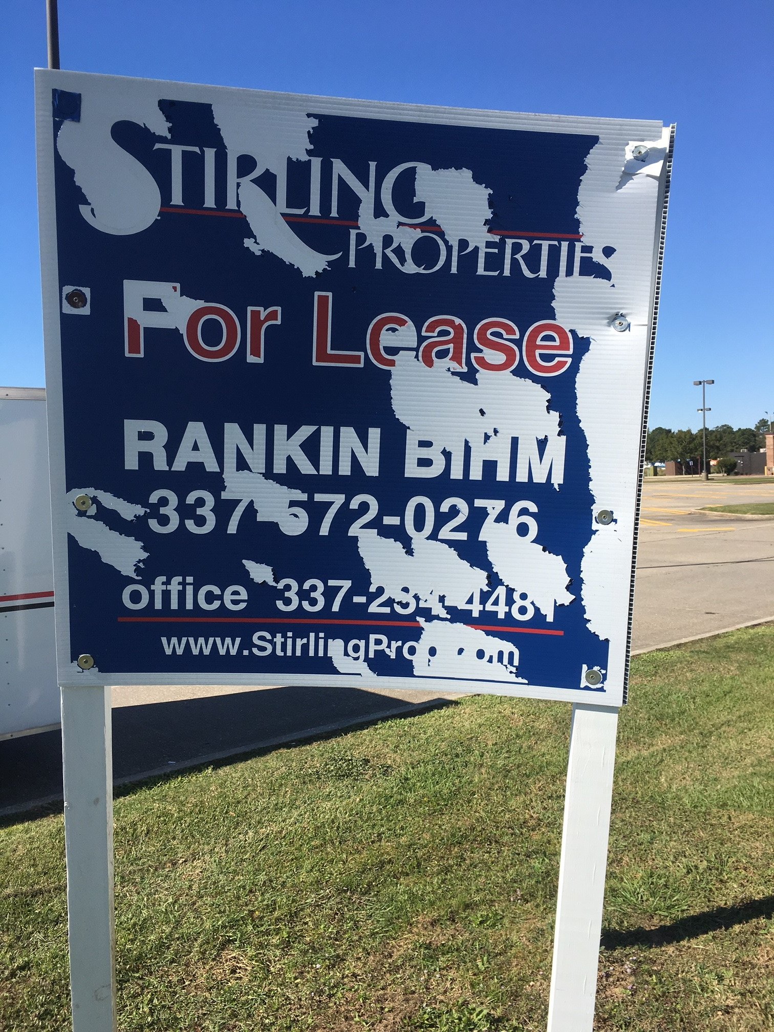

We have had some issues with our UV Ink not adhering to Coro signs. Mainly 10mm but sometimes 4mm. The sun facing side receives the most damage with these signs being only 6 months to a year old (some even less). The printer is a HP Scitex FB550 with HP FB794 series UV ink. The signs are allowed to cure but are unlaminated. We've been told before by our substrate supplier that this was due to a bad batch of Coro, but it has happened on more than one batch. Just wondering if someone with more experience could tell us why this might be happening and the best way to prevent it. I've attached a picture of an example.

This is common on coro with HP inks. The ink is incredibly sensitive to changes in dyne levels of aging corona treatments. You need to make sure your coro is fresh. Possibly switch from coro for 1 year plus signs

Check your max ink in your rip software. If you have the ability to limit to CMYK only...avoid using Lc Lm if you can. Even on So/so coroplast we have had good luck from day one of our UV printer experience.

we have had this issue on and off for years with our HP45500 and now with our HP FB750. We have noticed that it is a combination of bad (old) UV lamps that do not get hot enough after supposed 500 hours of use and bad coroplast. I don't completely undersdtand how the UV lamp can affect this in such a huge way. A light bulb is a light bulb, in my opinion.

We used to have Vutek printers with Mercury Vapor UV Lamps...they wore out over time similar to the HP's mentioned above. The lamps dont go bad, they wear out over time. The wavelength generated to Cure the inks degrade and dont cure as well. Its not a heat process but a hardening process initiated by the light wavelengths. Heat is more associated with Solvent, Eco Solvent and Latex inks. Heat is Bad with UV printers as most know...it warps substrates like Styrene and Coroplast. The other issue could be Quartz filters over the lamps that aren't clean as well. They prevent heat from getting to the material (some but not all) and allow the proper wavelength thru to cure the inks. We always changed our lamps around 400-500 hours maximum. The Led lamps today last 10k hours or more before replacement.

Corona treatment on 10mm Coro is always questionable since it doesn't move through distribution as fast as 4mm. The comments about UV lamp degradation are on target. Eventually you will have to replace lamps. In the interim, increasing passes may help some, you could also check profiles to make sure you aren't over saturating some colors.

Never happen. There are no inks gonna last much more than 4 to 6 years regardless of what machine puts it down or what manufacturer produced the inks. The 10mm Cor-X seems to not take ink as well for us, either. Never has. It seems to have a slightly different surface.
Also, with the lamps...... with your first pass, if the lamps are weak, they are not adhering to WHATEVER surface you're printing to, therefore each and every pass after that just adheres to the inks already there. So, your initial ink which has no adhesion will peel back, taking all the other ink with it. Kinda simple equation. If you painted a board with tempera paints for a primer and then painted it with 6 top coats of whatever paint you desire..... think it's gonna stay, just because you put 8 passes down ?? It's the old weakest link theory.

It’s kind of the perfect storm with Coro and things not going as planned. Coro doesn’t like heat exposure but older UV ink systems require more UV curing exposure to it = more heat. UV inks do not like to stick to heated surfaces, they adhere great to each other but not to some Coro without extra steps. You can try to wiping them down with alcohol (some Coro has a film/coating left over by the manufacturing process) and/or try to apply a promoter. Coro over the years has also changed and the surface is generally less porous, making it difficult to print on and low ink durability. UV printers from years ago and even now, do not provide enough velocity that inks are propelled through the print heads for the newer media with less porous and harder surfaces to penetrate the substrates’ surface deeper (microscopically) to begin with.
Low UV lamp efficiency is a killer (UV lamps produce less and less UV wavelength every time you use them, at some point, they need to be replaced). On top of that, HP had stoped developing their UV inks to keep up with changing media years ago

We had this exact issue. We resolved it (after a LOT of trial and error) by coating every coroplast sign we print with an adhesion promotor we bought from Grimco made by Supply55. The product is "AP3155". A little goes a long way. At the same time we bought that product, we changed the coroplast profile in our FB550 to a newer one that uses less ink. I can't say for sure which of these resolved the issue, but between these two adjustments, we have not had a problem since. Good luck!

Wow...thats a lot fo added labor just to print to coroplast. I would say the Lower ink levels would have worked on the 550. Also changing to CMYK and removing LC & LM if you have those would also help.
