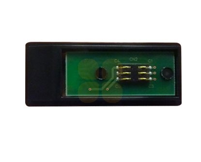

I have repaired this problem quiet a few times in fact I have just finished repairing this issue on Monday.
I have ordered these from Digiprint but others are available.
Your issue is the chip/card reader as picture attached.
The pins get bent as the cartridge is inserted which gives you your fault.
It's a fiddly job (except K) to replace but definitely a DIY job.
Would you like me to talk you through it?
