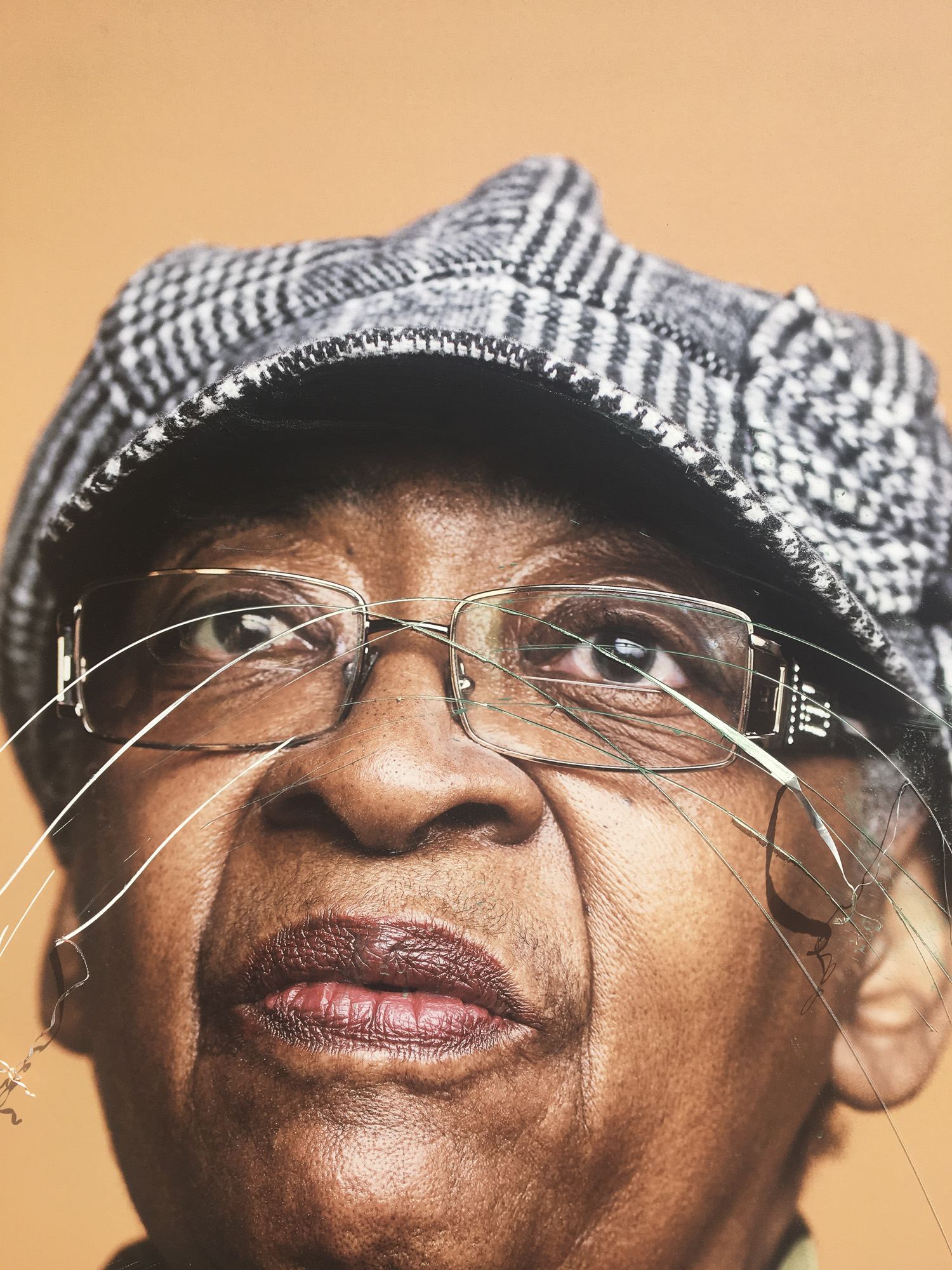

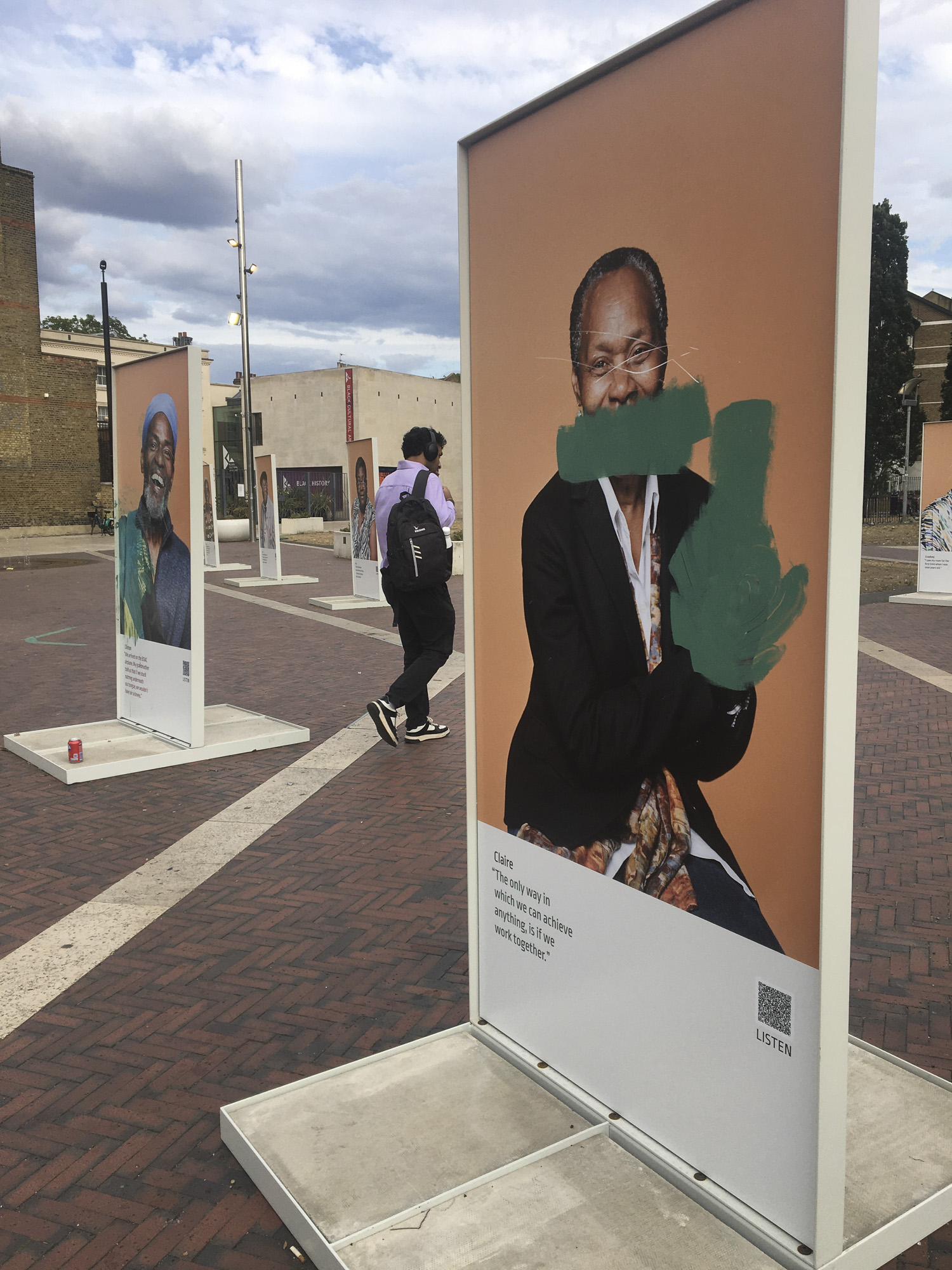

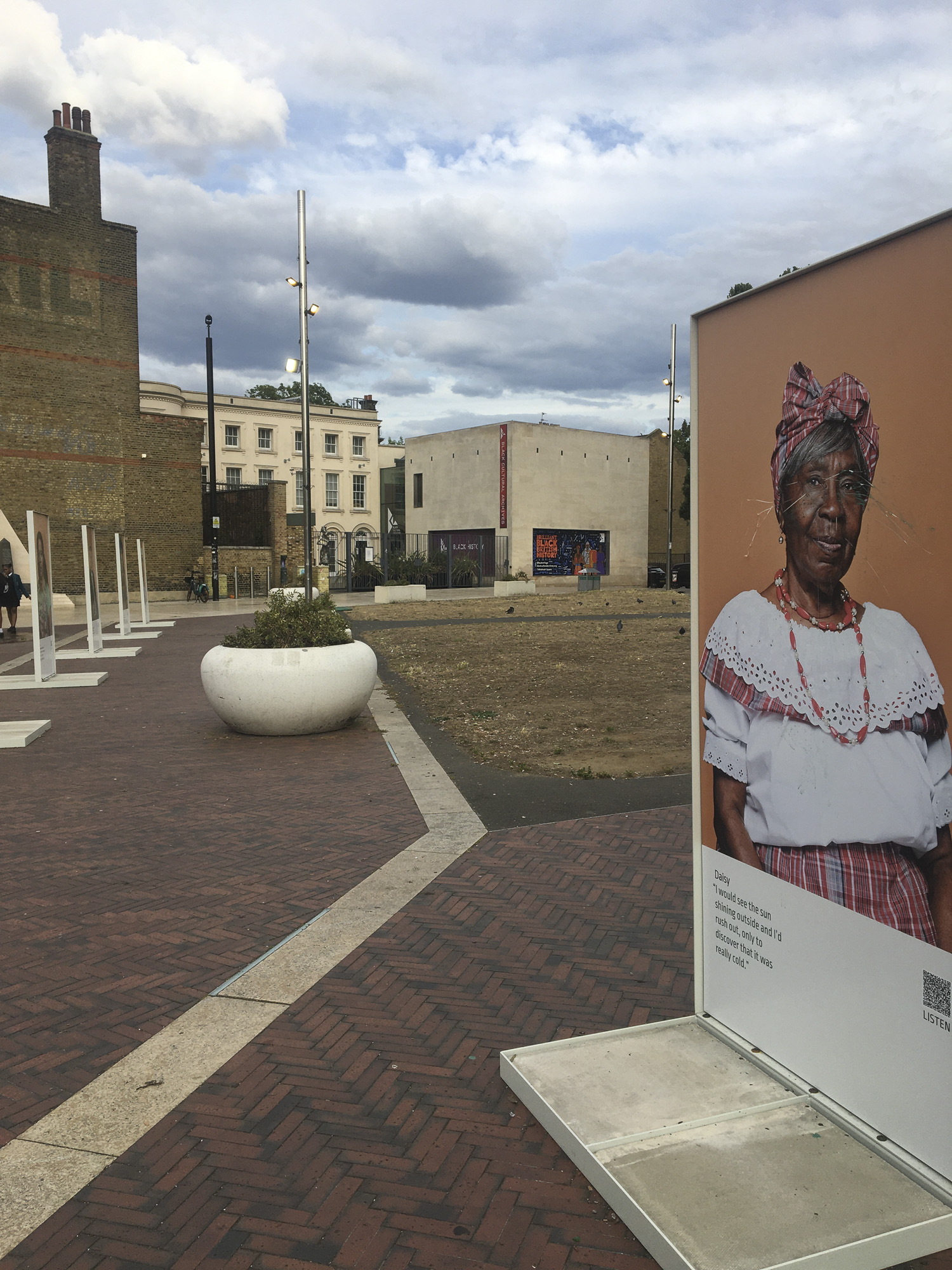

Finished a (for us) pretty large set of portraits 20x 1000x2000mm portraits - printed, laminated, mounted (wrapped) on 3mm DiBond - that were installed in a local local square, a couple of weeks ago.
Last night someone took a utility knife to them all, taking out the eyes.
Anyone know of a laminate that can protect against a psycho with a utility knife?

Thought is to slash one of my test pieces in the print room (small section), try sanding with ?300grit?, and apply a patch over the portraits. If this works, then test on one of the pieces in situ. To add to the repair fun, the fucker also applied paint (type tbc).

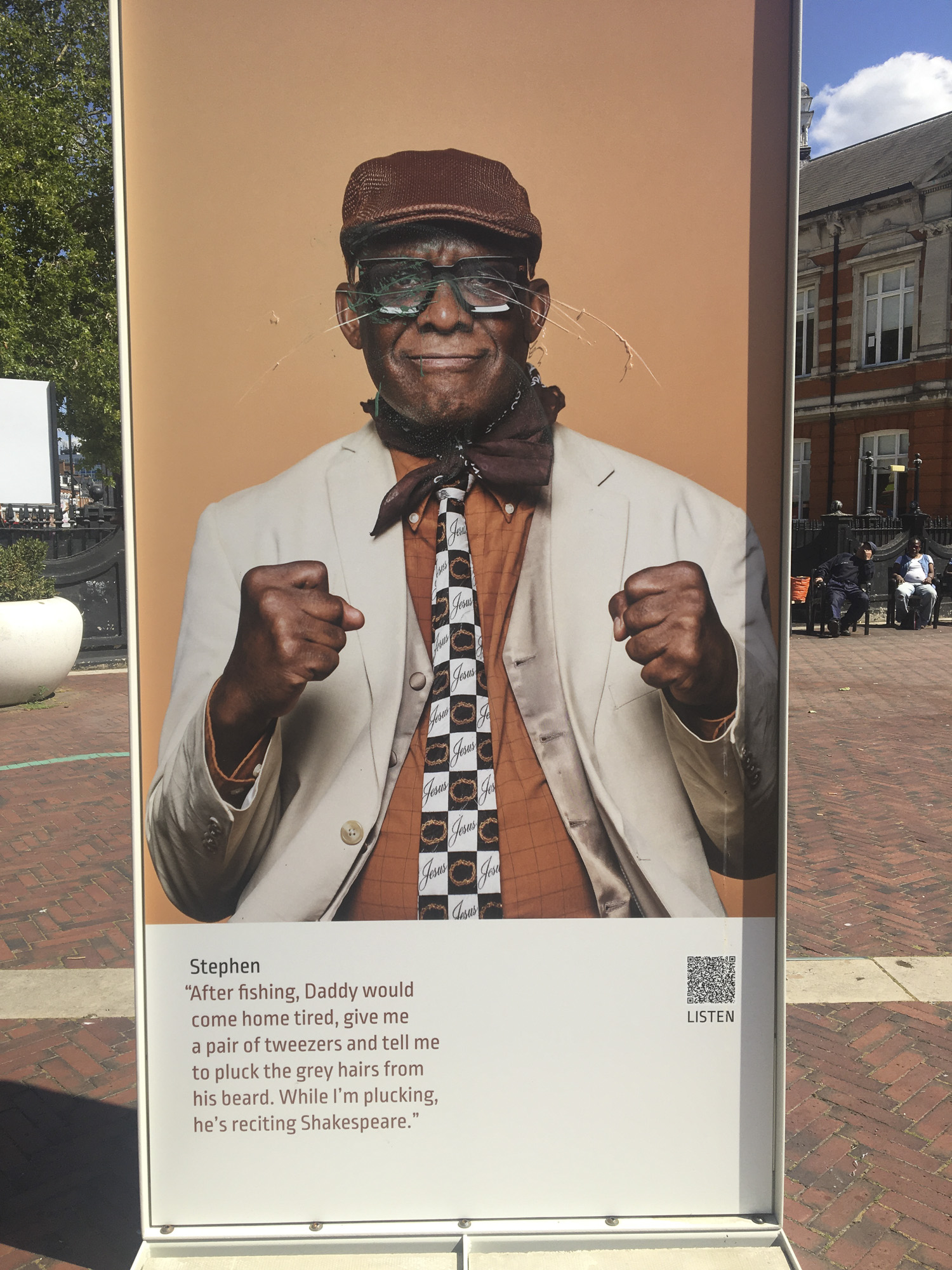

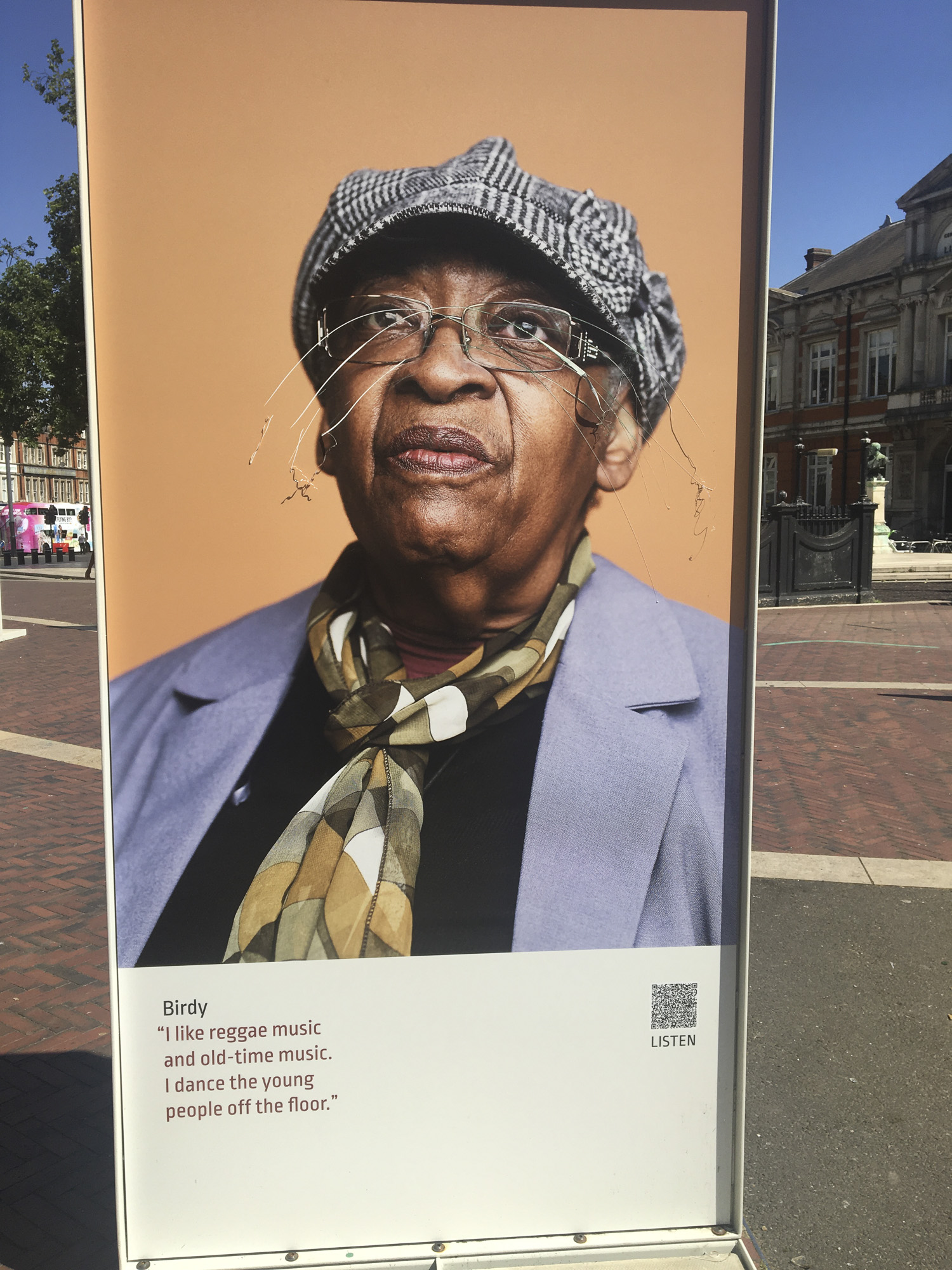

The dibond pieces are held place with 3m Duolock, as we were considering the need to replace the odd piece in the future, just not the whole freaking set. IMG_5313.jpg IMG_5308.jpg IMG_5307.jpg IMG_5306.jpg IMG_5314.jpg
Seems to be a common theme. Those scratches will telegraph through, so while you won't see the actual scratches, you'll see lumps and stuff.
You'd also hafta replace the green painted areas and number ones.
