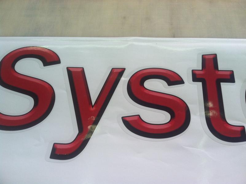

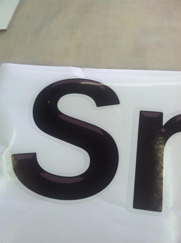

I know I have mentioned this on here before but after looking through tons of forums I still cannot figure out this tracking issue on my Roland Versacamm VP 540I. I have attatched pictures of simple text with a .25 contour on the image. The carriage cable is great, we have a brand new blade on it and 3 pinch rollers. I have tried to cut fast and slow and still the same outcome. Any help is greatly appreciated. I'm tired of ruining even small cuts.

Is slides left to right when tracking. The rollers are all good and clean along wit the bottom grit rollers. I have no idea why it would off track that much though. If I were to cut a 2' x 6' logo it would still off track by the paper sliding. Do I add more rollers? Just kinda losing it and again as mentioned im tired of losing prints or doing in pieces

When I say the paper slides if I line up dead straight the sheet slips left and right. For some reason just doesn't want to feed straight regardless. I will try to get am additional pinch roller and see if that helps and them look onto carraige cable I guess. Just hoping to fix before I go and buy a new ploteer
