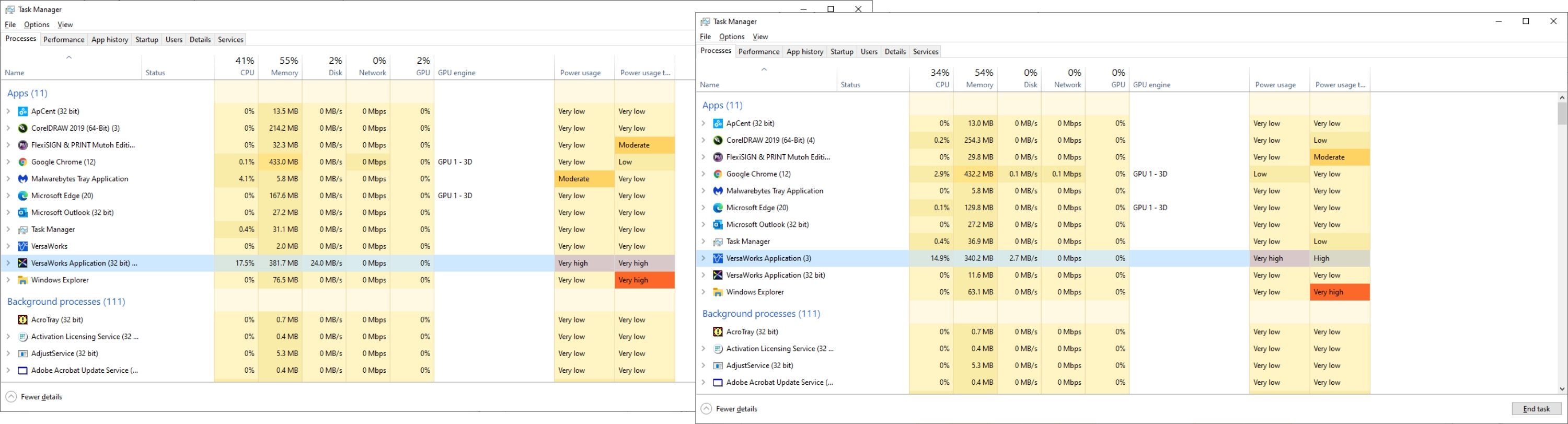

No nothing else.Are there a lot of files in the RIP que? That slows VW to a crawl or crashes it.
No nothing strangeDo you have a strange profile set? I have one or two profiles that just take ages for whatever reason.
What profile do you mean? Where?Do you have a strange profile set? I have one or two profiles that just take ages for whatever reason.
I mean your ICC profile in VersaWorks - like the media type dropdown menu that you'd change depending on which media you're using.What profile do you mean? Where?
YUP! thats it. I was using GCVP from roland when I switched it to generic banner it took a minute.I mean your ICC profile in VersaWorks - like the media type dropdown menu that you'd change depending on which media you're using.

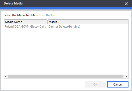

I am trying to delete them, and it wont let me delete. the option is greyed out when I select delete. How do you delete them?
Do you mean in VersaWorks? I wouldn't suggest deleting them until you've got a replacement, but I imagine you could probably delete them in the Media Explorer window (under Media in VersaWorks), either by right-clicking and choosing "delete" or hitting the trash can.

Yes in versa works it says they are genuine and cannot be deleted. They werent there until i added them, and now it wont allow me to delete them.
