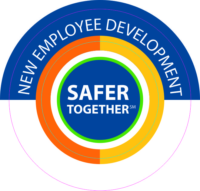

Actually, what I am trying to do is cut two circles. The outer circle will be a full contour cut and the inner circle will be perf cut with tabs but with the same force as the contour cut, not to cut through the liner. The intension is when the whole sticker is pulled off the liner it will grab both the outer and inner circle. At a later date when they want to pull off the outer circle leaving the inner circle.

Why not just use the CutContour on both? Have the outer be a solid stroke and the inner be dashed stroke? Then you can do the test cut etc from the machine.
